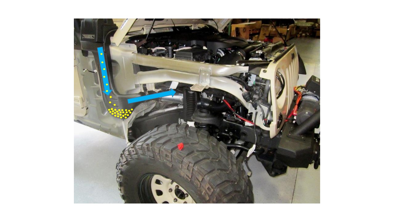

The best pre-filter is probably the 3" TopSpin Pre-cleaner.
Most snorkels have direct and almost horizontal air flow to the air filter box.
The Rugged Ridge modular Snorkel is different, by having a 'sink' under the battery. Because the sink is wider than the pipe, it slows down the air flow and makes it flow in a way that causes sand dust to sink at the bottom. This prevents much of the heavier sand dust particles from reaching the air filter, even without a pre-filter.
(This does not eliminate the need for a pre-filter for the finer-grain sand dust.)
Name:	# - Rugged Ridge Snorkel - FLOW - SINK.jpg
The sink can be drained.
The high mount is tucked in a bit relative to the A-pillar, so it's less vulnerable to branches.

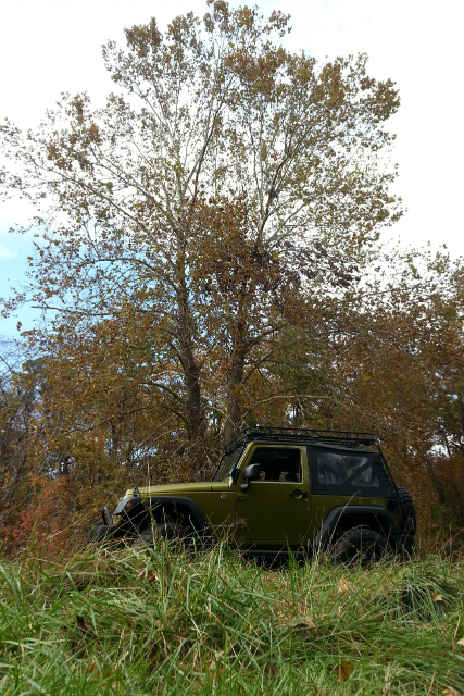

For the rigs with roof racks, what size cb antenna is common and where is yours mounted? I have a Garvin rack and I'm putting a cb on my Christmas list. I don't know if a 3' or 4' antenna would be best though. I guess what I'm asking is what is the shortest antenna that would still be functional? Also, spring or no spring at the base?

Mine is mounted on a rack I made that is attached to the OEM tire carrier nutplates. Right now I have a three footer. It just barely pokes above the rack. With over three decades of radio maintenance experience in USAF and before (technician ham license in the 60s and 70s--WB6MPD), I know that is terrible for performance. But any taller and trees slap it around and it quickly breaks internally. Though my range is limited to a half mile or so on the trail and I can't get seriously good SWR, those are better than no CB when it gets broken (as has happened several times). I also wrapped the antenna with F-4 tape (Google it) where it slaps against the trail rack.
