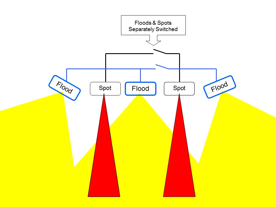

Originally Posted by nhk19
OK....stupid question but I'll ask. Getting the MBRP roof rack like Mark Doiron has and similarly want to put individual lights across the roof. I will be getting the MBRP light "bar" that attaches to the windshield bracket so it will hold 5 lights and they'll be lower than atop the roof rack itself. Here's the question. Those that run individual lights as such. What's the combination of lights? All spots, all driving or a combination? I.e. - Spots on outer most positions and driving lights in between. Just wonder what works best for you that have this type setup.
Thanks!
NORTHRIDGE4X4
That's not a stupid question at all.
A combination allows more options.
Using 3 floods at the corners and the center, would cover a wider area with even illumination.
Aiming the corner ones somewhat to the sides, help when taking tight corners as they illuminate the way you’re going to get to before you get there.
Most offroading is done at slower speeds, for which a wide light pattern at relatively near distance is the most productive.
Having the 2 spots (or driving) lights placed closer together, reduces the two separate & very bright light spots effect on - for instance - an incline just in front, which can be annoying at nearer distance.
Name:	### - Light Bar - Lights arrangement.jpg
Having the spots/driving light separately switched adds to the practicality.
Also, remember that when a spotter guides you over an obstacle in the dark, your lights would blind him/her. For that, better turn off every light you don't really need, and let the spotter work with a portable light. Simple LED rock lights are great for this.

Originally Posted by GJeep
That's not a stupid question at all. A combination allows more options. Using 3 floods at the corners and the center, would cover a wider area with even illumination. Aiming the corner ones somewhat to the sides, help when taking tight corners as they illuminate the way you’re going to get to is illuminated before you get there. Most offroading is done at slower speeds, for which a wide light pattern at relatively near distance is the most productive. Having the 2 spots (or driving) lights placed closer together, reduces the two separate & very bright light spots effect on - for instance - an incline just in front, which can be annoying at nearer distance. <img src="https://www.jk-forum.com/forums/attachment.php?attachmentid=631528"/> Having the spots/driving light separately switched adds to the practicality. Also, remember that when a spotter guides you over an obstacle in the dark, your lights would blind him/her. For that, better turn off every light you don't really need, and let the spotter work with a portable light. Simple LED rock lights are great for this.
Perfect! Thanks so much for this detailed reply. Diagram is helpful and I saved it. Exactly what I was looking for and couldn't find. This set up makes total sense. Definitely going to take your advice. Thanks again!
I'm glad this helped.
A similar arrangement of 2 or 3 smaller floods or diffused LEDs at the rear of the roof rack makes reversing much easier.
As less distance is needed, they can also be aimed down, around 40 to 60 degrees. This way they don't blind drivers behind you, and shed nice light spread for camping.
The same light, when offered as either flood or diffused, the diffused will give wider spread but less light per square feet, and will also look less blinding.
