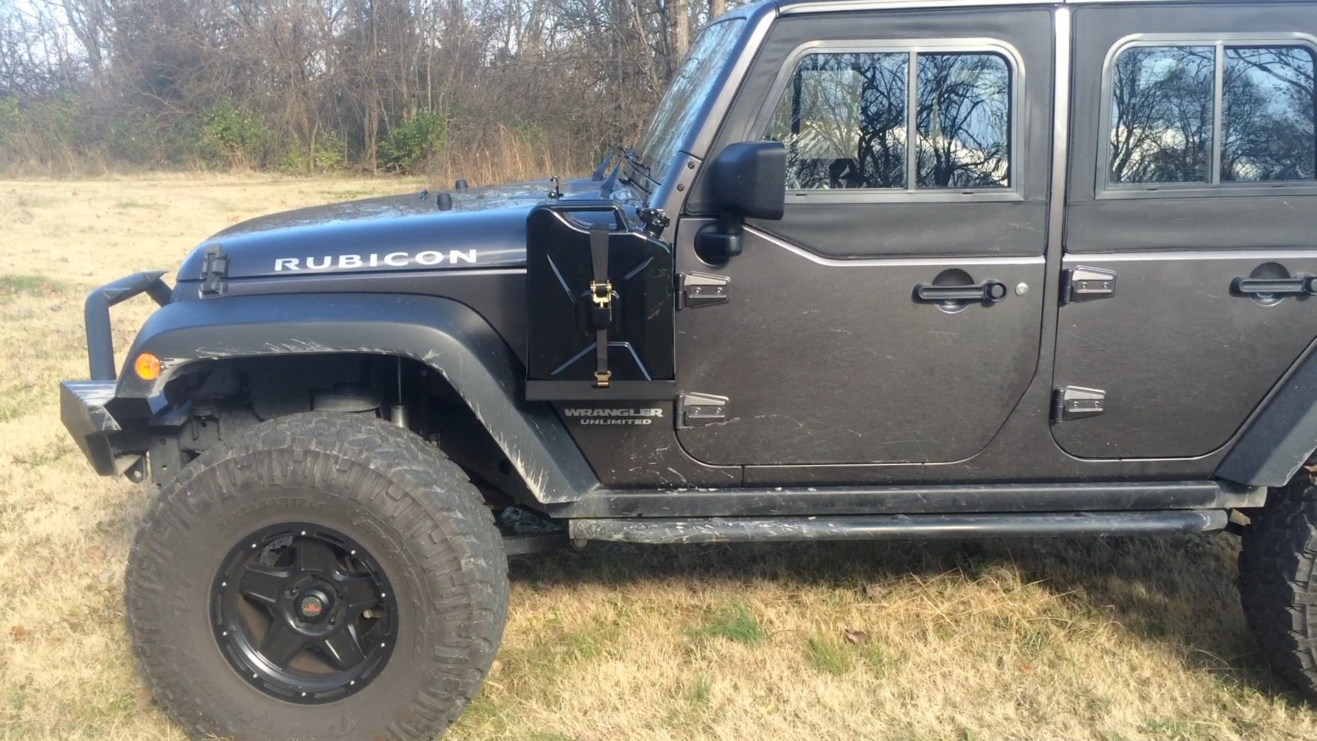

Default Well after weeks and weeks going back and forth
to mount two jerry cans on the rear of the jeep or one here on the side i pulled the trigger on this one.
i have two cans and could have put them on the back with two of the ace style holders , but felt id never have the two filled and it just
leaves two cans available for some one to steal as we know some people will try.
My thought is to use a large hd eye bolt several inches tall in the hole that comes for the cb Antena and then run a long hoop lock through the handle
to the eye bolt. thats the thought anyway . I really like the look of this up front rather than in the back , it will be empty most likely hope it looks good i think two cans on the back would be to much clutter for me and in the way

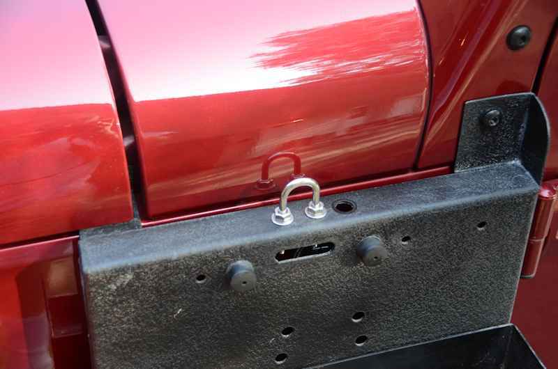

The company's instructions include a section on locking a can to the side mount: http://www.morryde.com/uploads/downl...%20Carrier.pdf
The mount now includes bolt holes for a u-bolt, which is used along with a bike lock or similar to secure the can to the mount.

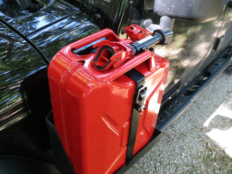

Cool why dont you send me one of those slick lock straps you made
Name:	with spouts.jpg
ID:	634352 ..... not fond of the bicycle cable deal at all thats cheezy @$$ a $80.00
jerry can and a 4 dollar bike lock is like saying here take my expensive can

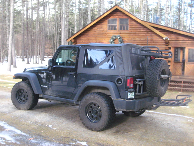

Where did you get your rear hitch rack? Love that it goes up then back.
Old Jan 11, 2016 | 06:02 PM
  #96
jeepmojo's Avatar
Posts: 2,318
Likes: 12
From: New Hampshire
Default Hitch Haul brand
yeh it works good it will hold 300 no problem up to maybe 500
i think even walmart . com might have them for like 60 bucks for atv suv i know cabela had them
it has a offset it works good when in reverse dropping off. it gives you a lot more clearance but my tire is on the Or fab carrier so its higher than others, there could be a clearance issue if your tire isnt raised up
mine hits the top rail when its 3/4 open but it does not bother me very seldom do i need the tail gate 100% open . i leave it on year round but you can obviously take it on and off . But i find it useful for taking bags of trash to the dump and stuff with out having to have it inside the jeep , you can carry anything . just very useful . I dont like the ones that go out straight at all.

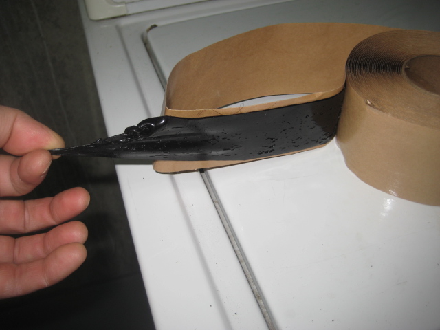

Default yes i thought of somthing i have its a rubber sealent
Originally Posted by jscherb
I've had mine on and off dozens of times in the past six months and there's been no marring of the paint, but if you were concerned about that you could put a thin piece of rubber, weatherstrip, or maybe gasket material on the back of the tabs.
it came on a roll its used for metal roofs and or deck flashing its very thin and comes off easy with no peeling realy
ill have it put under the tabs as you mention. If i were in a state that was dry im sure it wouldnt be a issue but we see rough weather here in NH
Last thing i need is more rust or any where water could get behind and sit.
