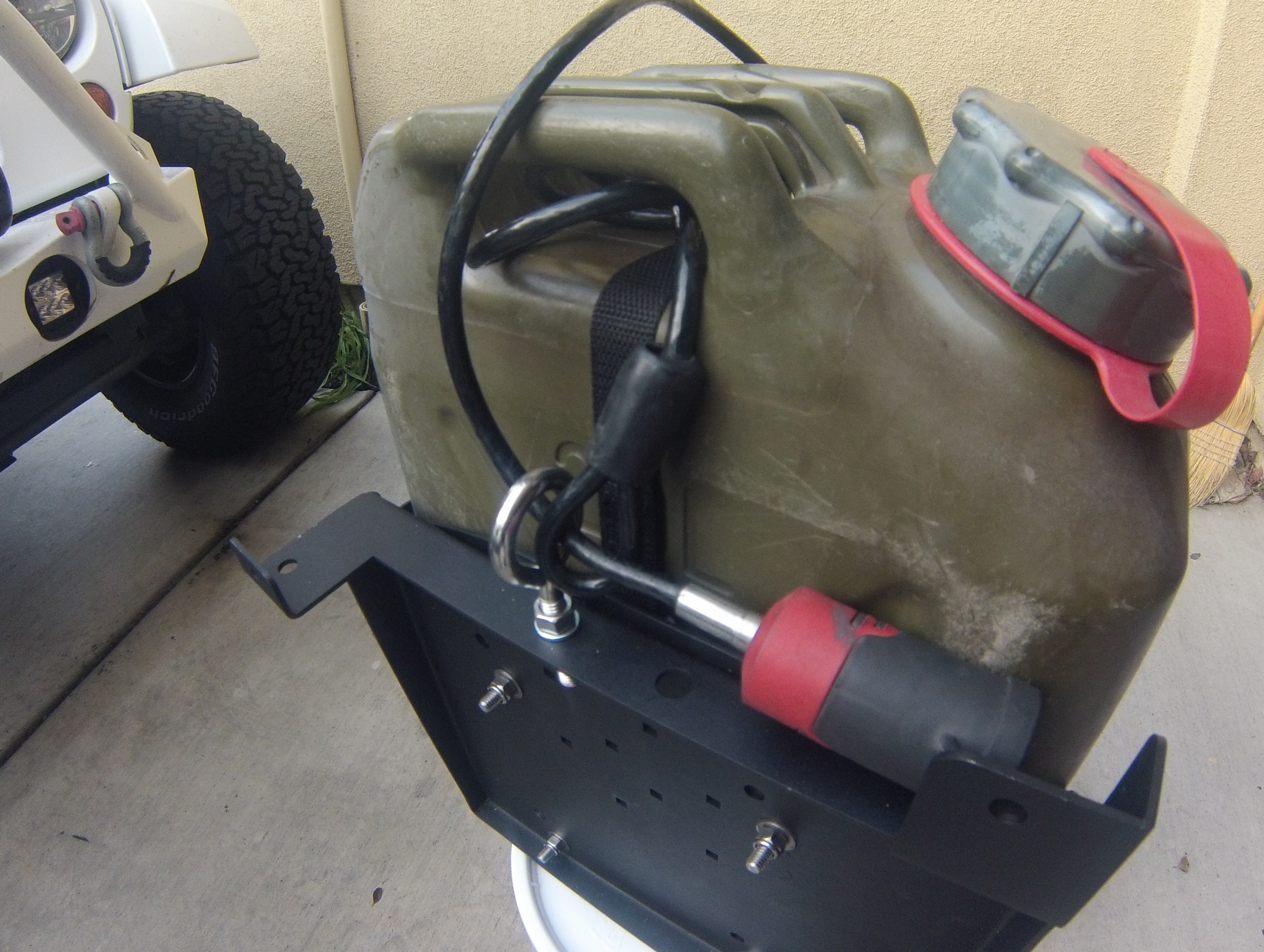

Also used one of my "bolt" brand cable locks which is keyed to my ignition key. I use the same kind of cable to keep my spare on lock and my hi-lift on lock plus my hood lock. All 1 key. Also got the "bolt" brand hitch pin locks and a couple of their padlocks for my tool boxes. With all the pin #'s, passwords, etc. you need to remember these days, I'm keeping things as simple as possible. Ignition key lol.
I did get pics of that. Used a SS eyebolt.....

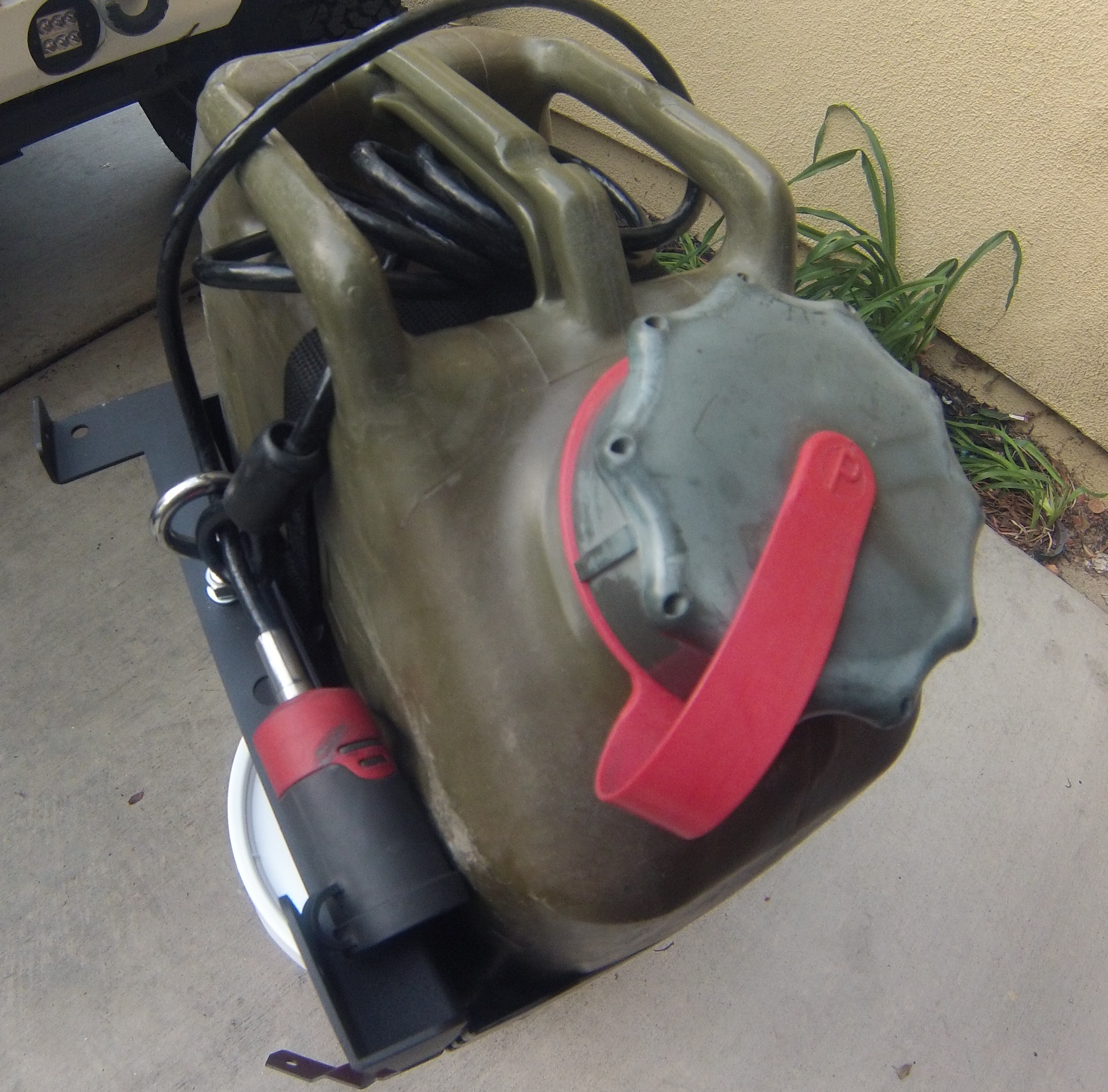

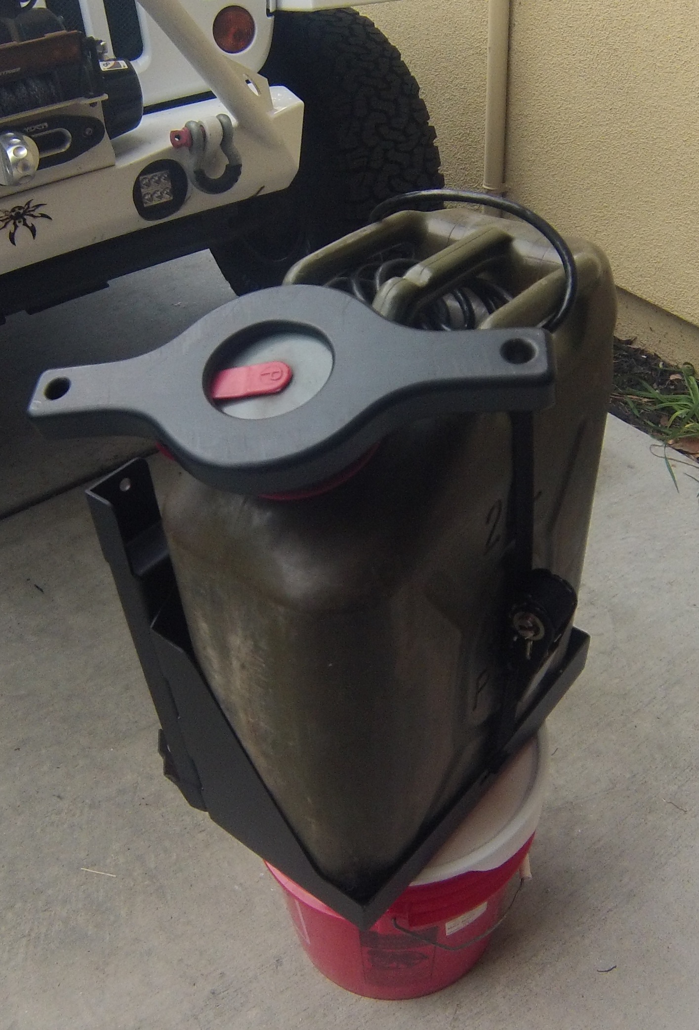

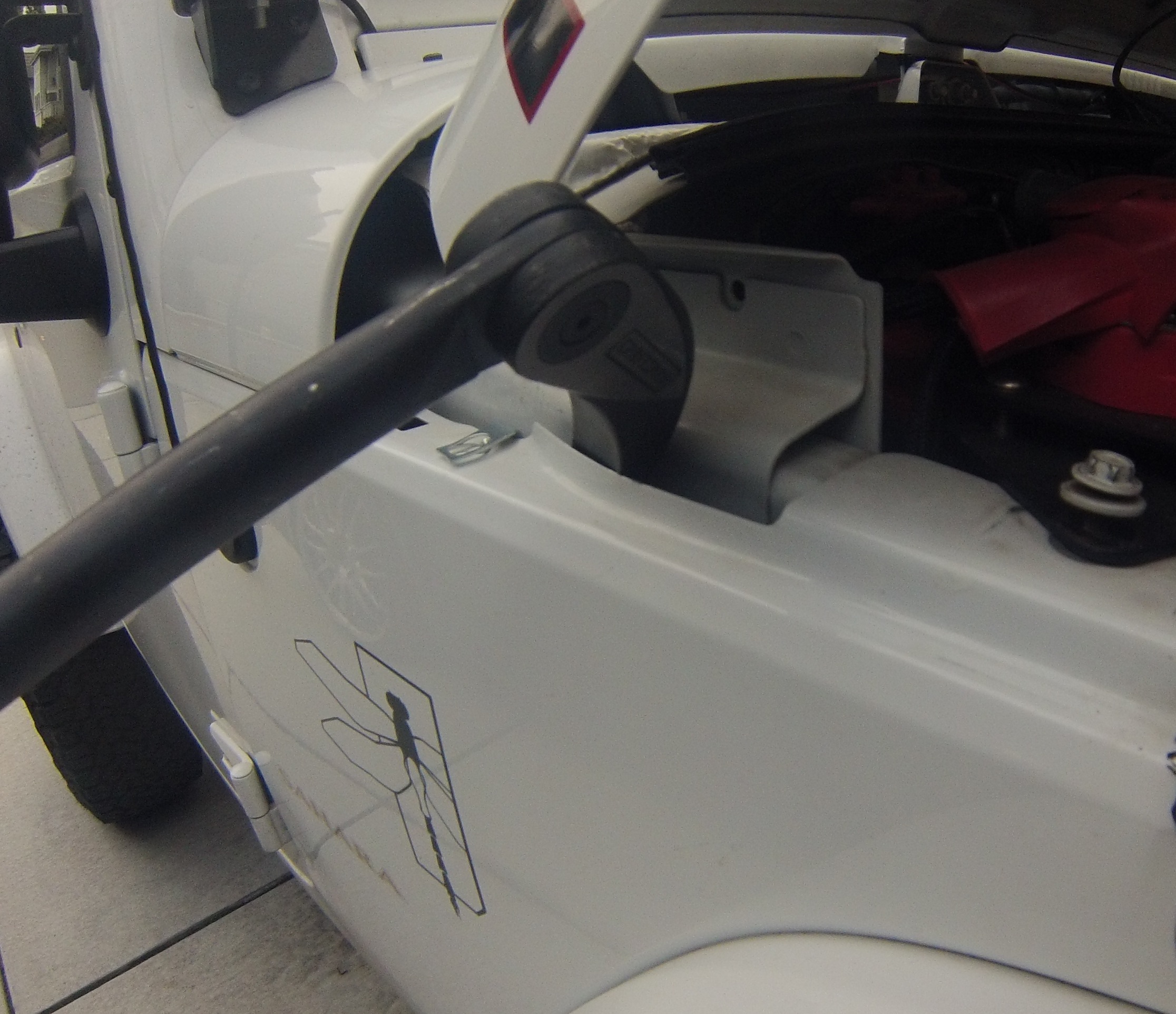

....and of course some initial pics. The 2nd pic you can actually see that door hinge bracket is bent. Even on the 1st pic it should be sticking straight out...

....I used this for the j-clip. Widen it just enough that you can slip and slide it in. That's what she said.
I even loosened the bolt first where part of my genesis tray is mounted which didn't help so the pry bar eventually came out. The sheet metal flexes back to the original factory location so no worries there. The front quarter panels are horrible though. Too thin....

It looks like it was ready to buckle it / with the crow bar .
when i saw how rigid the fender was The bolts were put back in &
the j clip was then opened up a tad and just tapped in to location at angle .
Hope bending it back didnt weaken its integrity
In that last pic with the crow bar no force is being applied. There's a natural bend there from the Jeep factory. I was just trying to show everyone where to place it if you use one.
But yeah, if going the crowbar route you need to apply very minimal force. Just enough where you can let the j-clip ride on that ridge and slide down.
I hear you on the bracket integrity part though. I've only bent it back out to it's approximate "factory" location in a couple of increments. So always bent back out but not in. Haven't tried adjusting it since.

Crowbars really shouldn't be necessary. Some gentle pressure is required, but I did both sides of mine without any prying tools - hands only.
