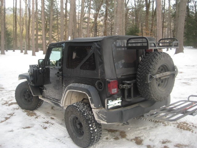

JScherb - some of my buddies are telling me that my new side-mount jerry can holder will harm the JK body tub with many hours and miles of backcountry travel. They're talking metal fatigue due to putting that much weight on a part of the body that wasn't designed for it. Thoughts? Here's some photos, typical of what I do with my Jeep. I do tend to go long distances of washboard/backroads mixed with a few challenging "jeep trails."
I've got the passenger side bracket installed, and the driver side bracket is on order.
Thanks!

Since you've already installed one side, you know that the side mounts are attached to reinforced structures in three places:
- the pillar that the doors mount to (using one of the door hinge bolts, the doors can apply a lot more leverage and weight to the bolt points than the jerry can ever will)
- the structure the windshield mounts to (using one of the same bolts many roof racks attach to, which carry more weight and can apply a lot more leverage to the bolt points)
- and one location on the top of the fender, prevented from movement by the optional self-drilling screw into the structure that runs from the body tub up to the radiator support (you should install this screw). The optional screw goes into the reinforced structure that supports the entire front clip of the Jeep, including the radiator, grille, fenders, etc., and trail use will apply more stress to that structure than the jerry can ever will.
These location points for the side mounts were chosen carefully to prevent any issues; they're plenty strong enough to carry full jerry cans on the trail without problems.
