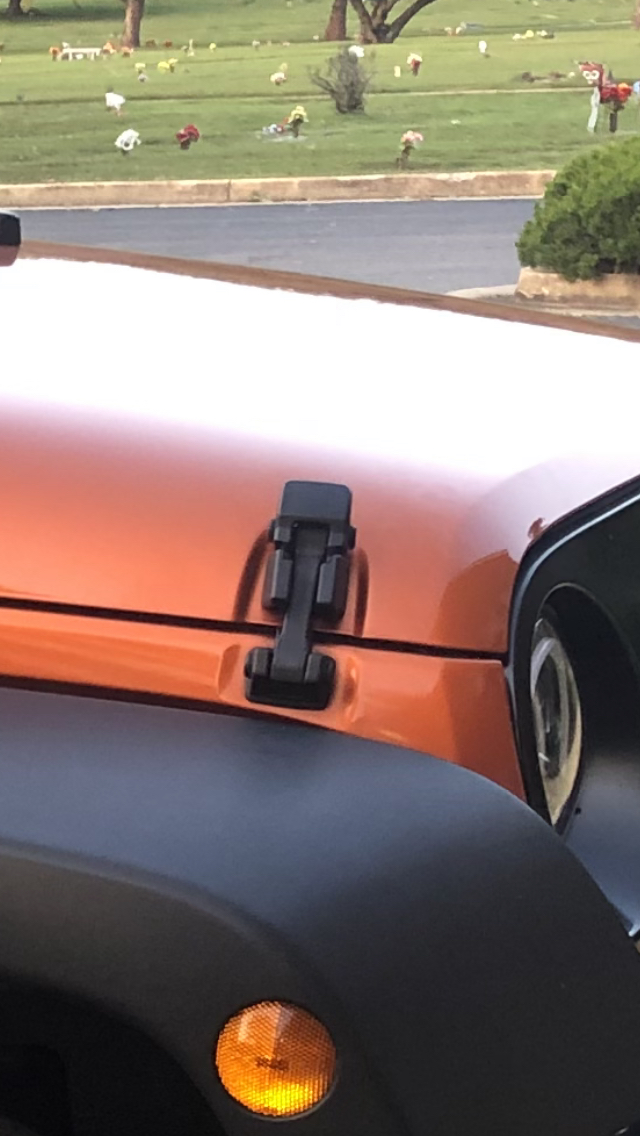

Mod of the Month...
JK Hood Latch, now OEM JL Hood Latch...simple install...no more hood flutter at speed!
