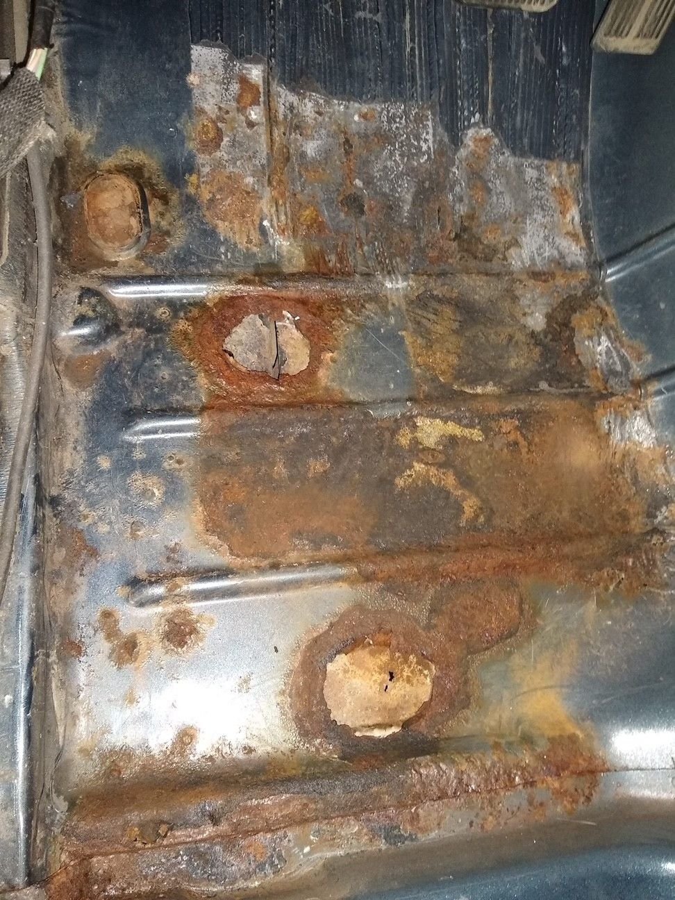

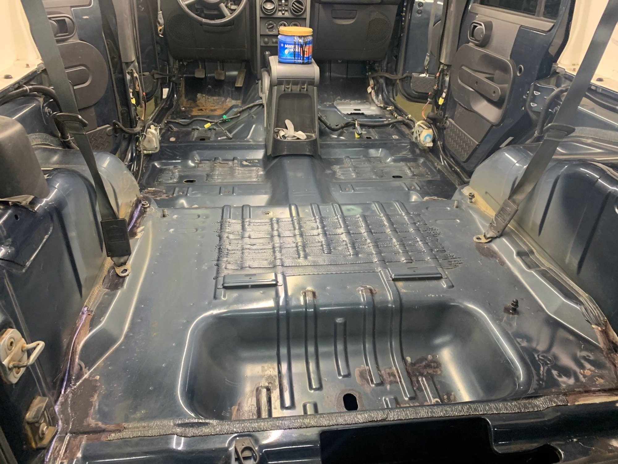

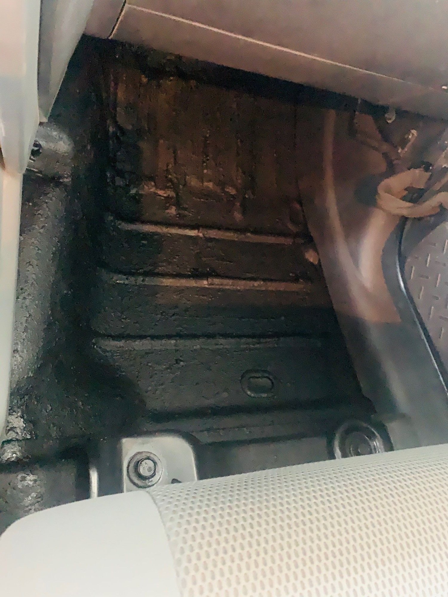

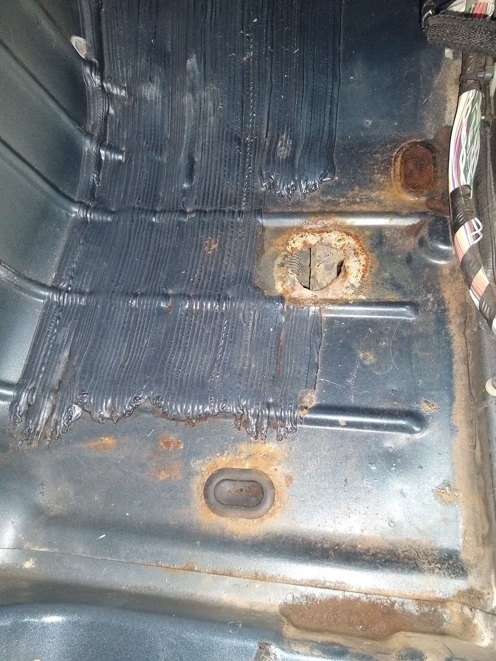

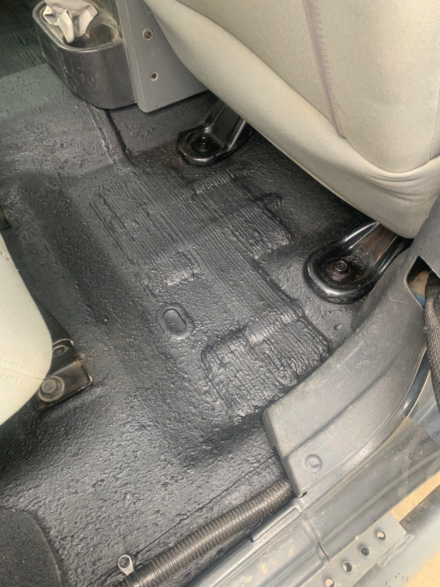

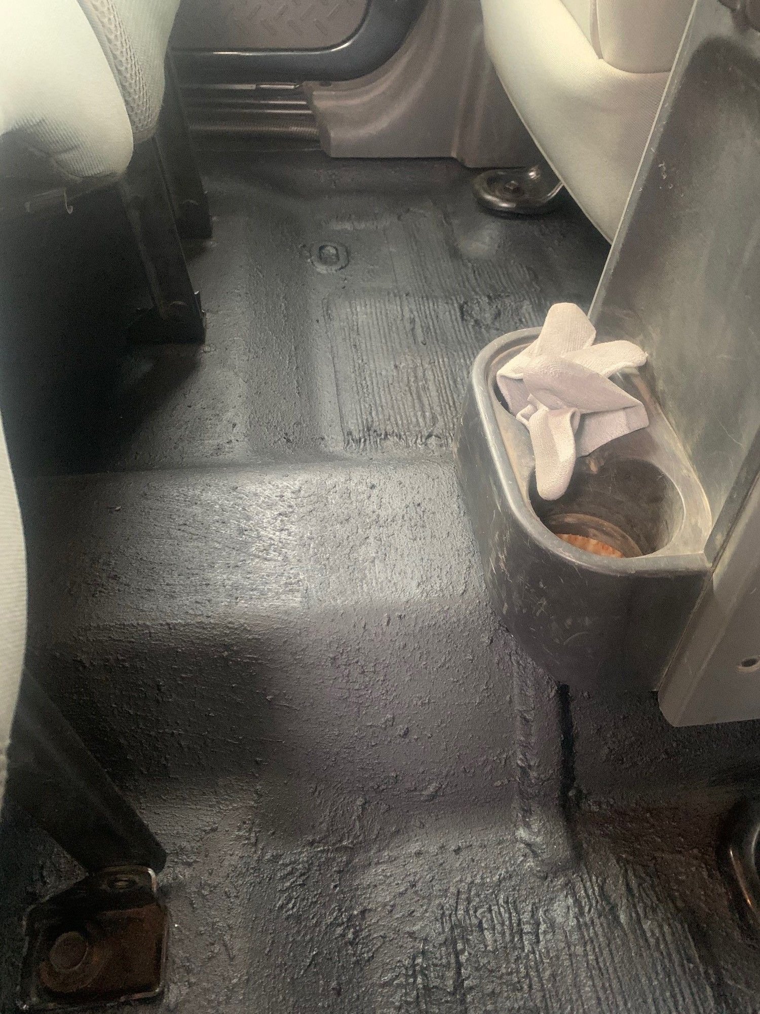

i decided to pull all the carpet out of my 2007 Rubicon unlimited....... Glad I did, found some issues. Driver side floor had to be replaced, ordered a part but wasn't very sturdy so my local garage/mechanic/welder fabricated a part. Passenger side was repairable and the rest wasn't bad. Then put Rust-oleum truck bed down. I debated and then put it over the plugs. I've never removed them in this Jeep or my old 2 Door. I did clean up the carpet and put it in the back area, leaving the front and rear seat flooring with just the bedliner and heavy duty Rugged Ridge floor mats. I've not noticed to much more road noise (Jeep was never super quiet), but after 20 years in the Air Force on/near the flight line my hearing isn't the best. Plus I listen to music rather loudly. lol I like it.......

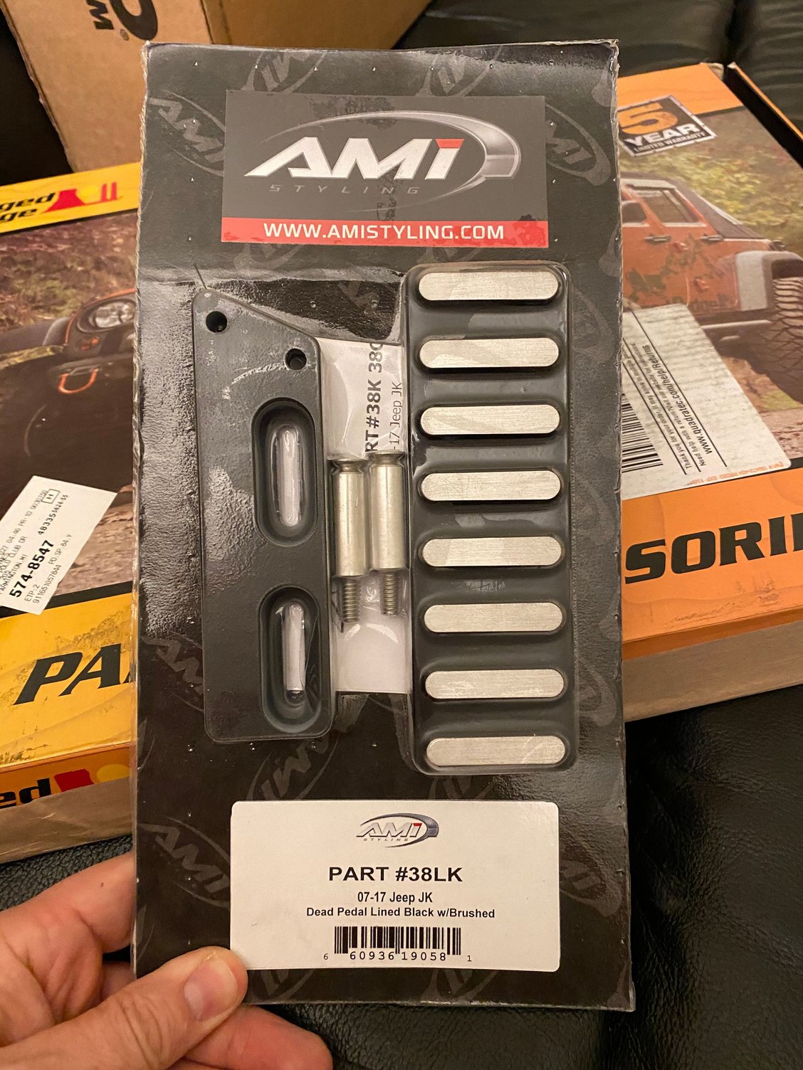

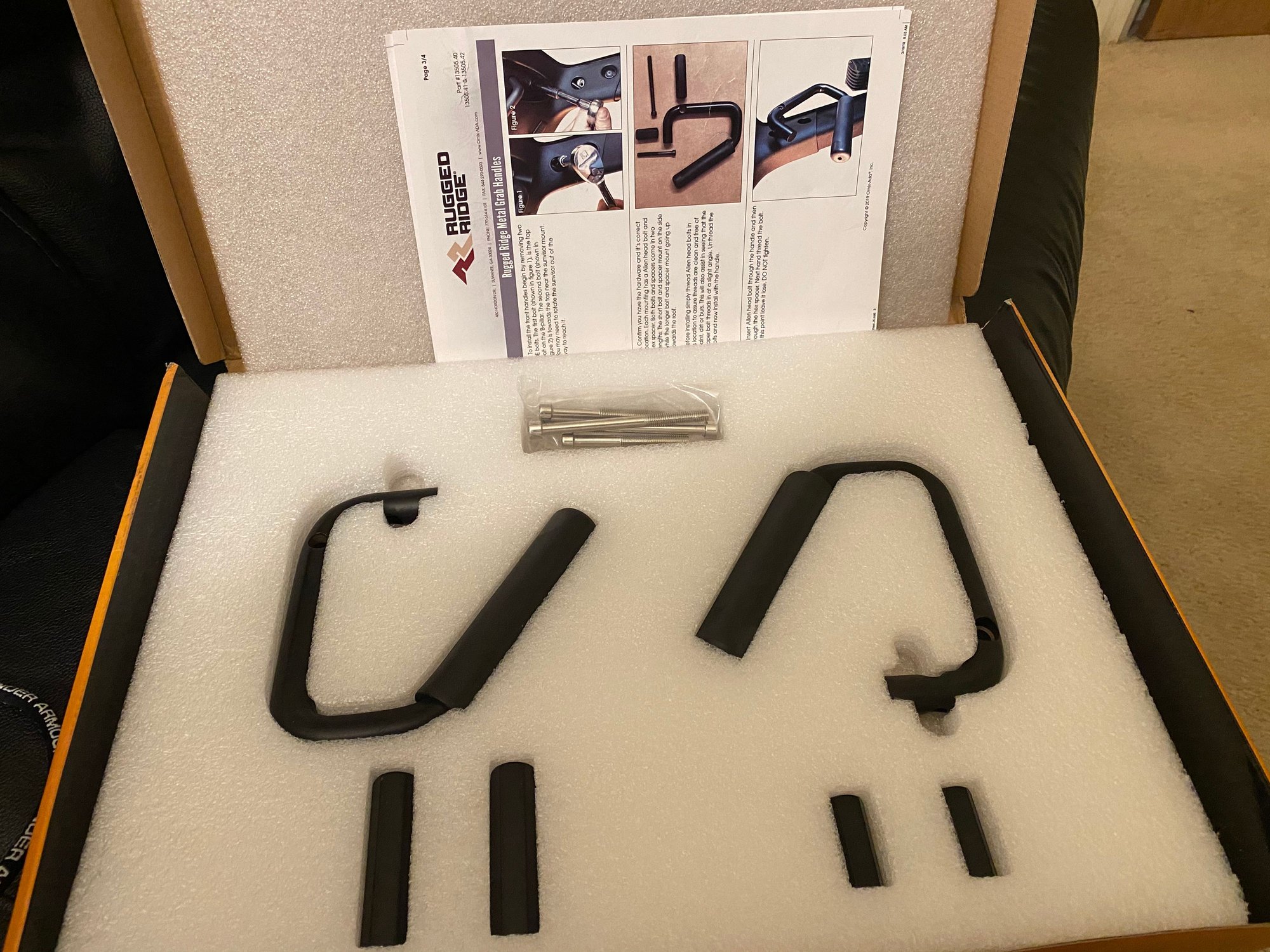

Had the 2017 JKU for a week now... second shipment from Quadratec arrived today with font grab bars and dead pedal.
Unfortunately there is a fairly big issue with the dead pedal... the screws are about 1/4” too short to be useful for assembling it!
Hoping to put the grab handles on in the morning- waiting to hear from Quadratec about the seemingly defective dead pedal.

Those come in handy. I did the red front and rear grab bars from an Amazon vendor.
