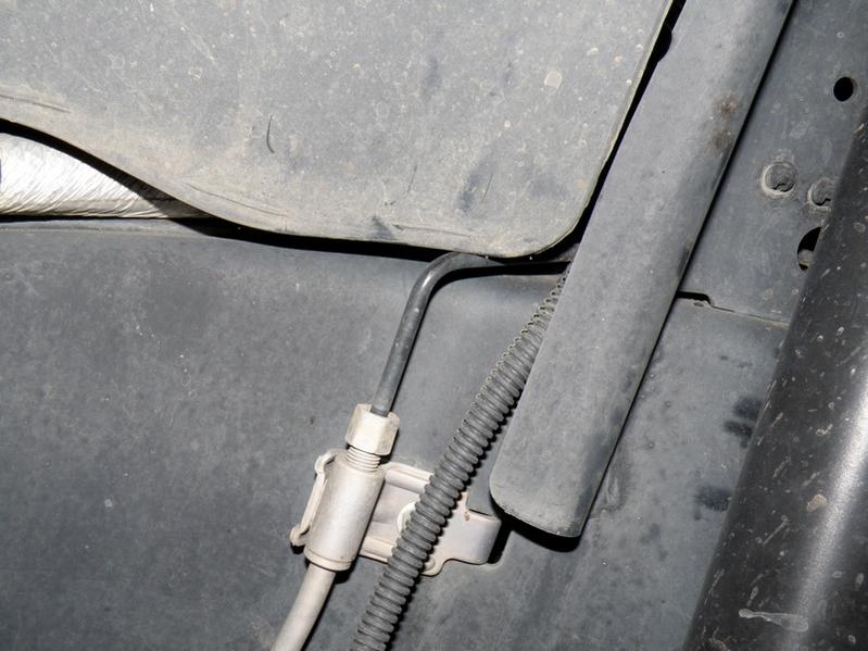

i need some pics of this touch point please..
i looked at my 2010 a few mins ago.. i cant see any place at all where the fender line is close to the hard brake lines.. maybe i looked in the wrong place.

Here is mine. I looked this afternoon, and sure enough it is rubbing.
