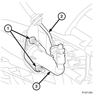

6. Remove slave cylinder
a. Remove bolts. 13mm x 2 bolts
Attachment 235922

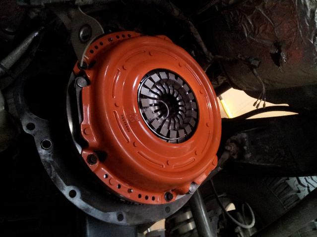

17. Install Clutch
a. Remove old clutch. 10mm x 6 bolts
Old clutch plate
Vs new
b. Clean flywheel (brake cleaner)
c. Inspect fly wheel for burn damage. If found consider replacing or having it machined, your local auto parts store will do this. Mine was fine as it only had 13k miles.
d. Use clutch install tool to align clutch
i. Find proper end cap
ii. Mount rod
e. Slide friction disc on making sure the proper side faces the flywheel (remove sticker)
f. Slide wedge down to center friction disk
g. Slide clutch plate over rod
g. Tighten plate in a circular manner a few turns at a time until all bolts are snug. 10mm x 6 bolts. I'd be cautious not to strip the bolts
Attachment 235922

17. Install Clutch
Old clutch plate
Vs new
ii. Mount rod
