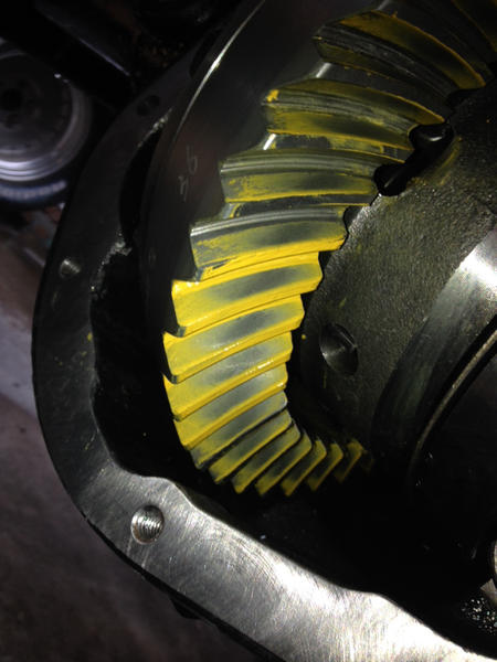

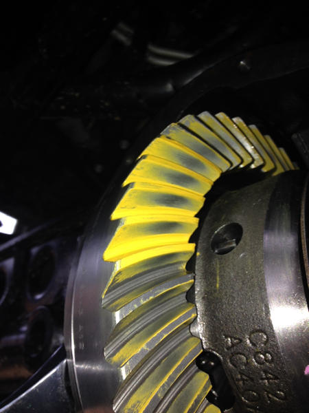

Anyone want to give their opinion on my pattern? Dana 44 front 5.38 gears.

Originally Posted by Slightlymodified
Anyone want to give their opinion on my pattern? Dana 44 front 5.38 gears. Coast side <img src="https://www.jk-forum.com/forums/attachment.php?attachmentid=518318"/> Drive side <img src="https://www.jk-forum.com/forums/attachment.php?attachmentid=518319"/>
Both look good to me
Old Dec 21, 2013 | 02:47 PM
  #127
Cjsmith4's Avatar
Joined: Apr 2013
Posts: 589
From: Pa
X2. Look good to me.

Those are pretty good looking patterns. Don't think you could get better.
