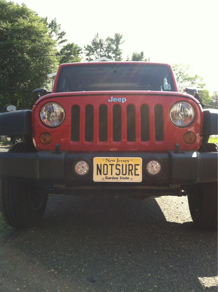

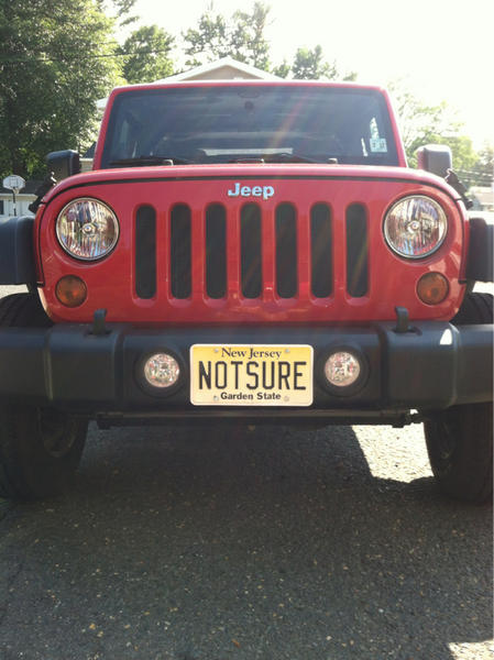

Just did it and I removed my air dam. Looks great. I did it with Lowes gutter cover and painted it with hi temp paint.

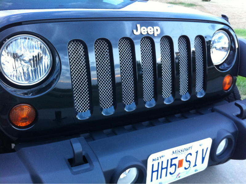

I completed the grill mod today. Looks really nice. I used the plastic gutter guard from Lowes and nylon zip tie blocks. I painted it silver with paint designed for plastic wheel covers. As suggested by others, I soaked the zip tie blocks in goo gone to remove the sticky tape. The hardest part was waiting for the goo gone to work so the tape would peel right off. It takes several hours at least.

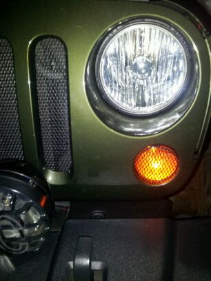

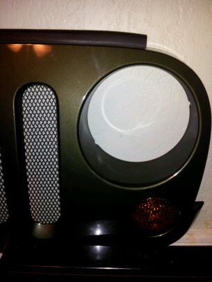

Just finished mine. Had everything laying around the shop so $0! Added a little twist that I hadn't seen and covered the lights as well.
<img src="https://www.jk-forum.com/forums/attachment.php?attachmentid=347892"/>
<img src="https://www.jk-forum.com/forums/attachment.php?attachmentid=347893"/>
<img src="https://www.jk-forum.com/forums/attachment.php?attachmentid=347894"/>
I was thinking the same thing when I did mine but could not figure how to make the mesh stay without it looking sloppy!
