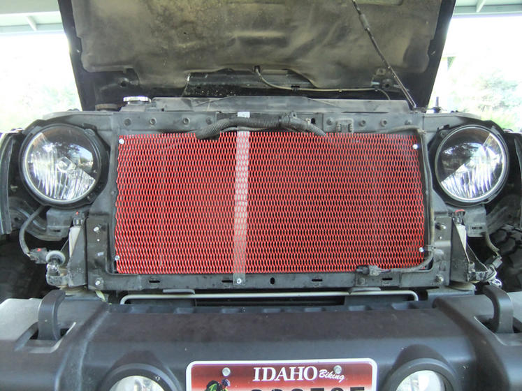

It has taken me a long time to get this done. I looked for the expanded steel for quite a while. Finally gave in and went to the local steel supply company. Ordered my piece of 1/4" by 18 expanded steel. Waited for a week for them to cut it. Dropped it off at the powder coat shop and waited for another week. I didn't want to deal with the zip ties and blocks falling off. I have heard mixed reviews about the performance of the blocks. So I screwed it into the frame behind the grill. I had to trim the steel in a couple of places.
Attachment 355242Attachment 355243
I am very happy with how it turned out!! Worth the wait!!
Great idea - streamlines the whole cutting/gluing/mounting and looks like it's easy off if needed -

Originally Posted by Weak129
What kind of screws did you use?
I used self tapping screws. #10's I think. Used a 5/16" nut driver on my electric drill to run them in. Don't get carried away, doesn't need a lot of torque.
Anyone else considering going this route I recommend a 13"X27" piece of steel. I would have liked a litte more overlap with the upper and lower cross member than what I got with the 12x27 I used. I'm pretty sure 27 wide Good luck
