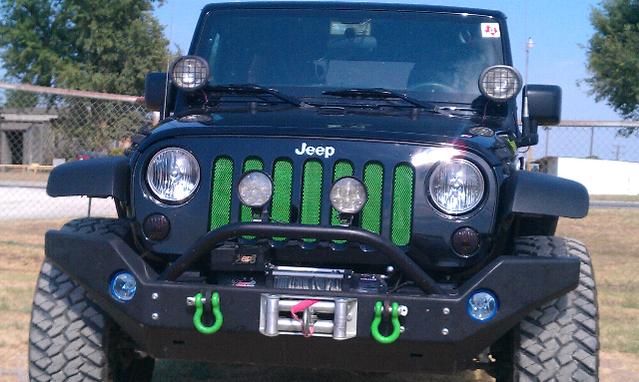

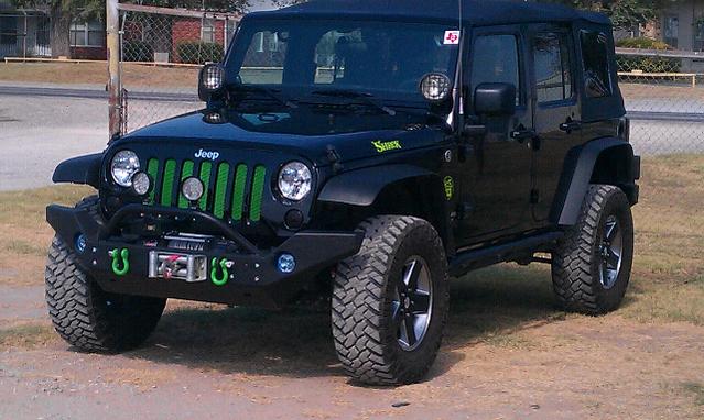

Got mine done and happy with it. Soaked the tie blocks in Goo gone tape just slide off with no problem. Let them soak over night

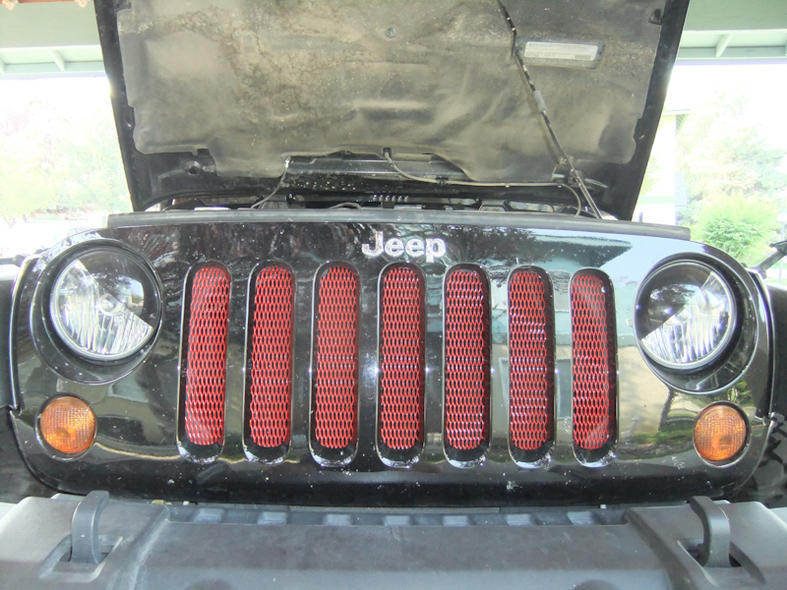

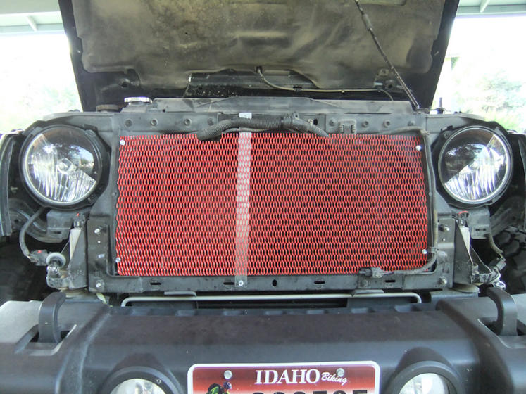

It has taken me a long time to get this done. I looked for the expanded steel for quite a while. Finally gave in and went to the local steel supply company. Ordered my piece of 1/4" by 18 expanded steel. Waited for a week for them to cut it. Dropped it off at the powder coat shop and waited for another week. I didn't want to deal with the zip ties and blocks falling off. I have heard mixed reviews about the performance of the blocks. So I screwed it into the frame behind the grill. I had to trim the steel in a couple of places.

I am very happy with how it turned out!! Worth the wait!!
<img src="https://www.jk-forum.com/forums/attachment.php?attachmentid=355242"/><img src="https://www.jk-forum.com/forums/attachment.php?attachmentid=355243"/>
What kind of screws did you use?

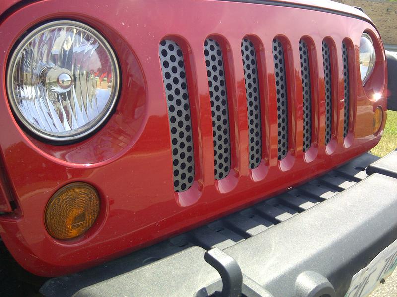

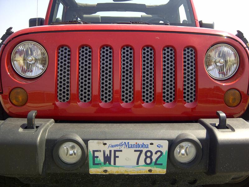

Removed the gutter gaurd version a couple weeks ago and replaced with expanded steel. Bed-lined first and then painted the same color as the rims.
