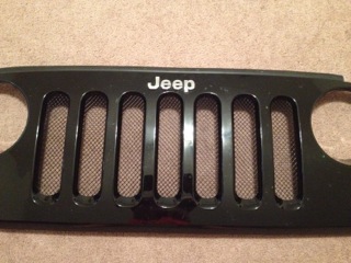

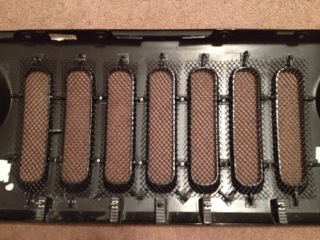

Did mine today, used a 13gauge 16" x 30" separated steel sheet found at a local Ace HW, lowes and HD had nothing similar. This was thick enough to contour it for the curve of the grill shell. Only had to trim an inch from one end and fitted the bottom around the clips. Now my grill is 10x as rigid

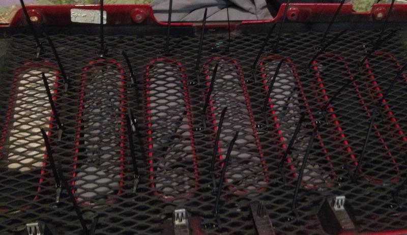

Paint first so its ready for install!!
I Took out the 6 plastic screw- did by hand - hint hint
Pulled gently by the blinker- not to hard now its still connected
Pulled red tab out FIRST- then pulled plug out
Pulled bottom out
Have grill ready
Laid all the tie downs - 3 going down and one on each top hole
Zip tied each one using a small screwdriver to help get the tie up
Re Install the grill and Vuala!!

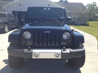

I used plastic gutter guard that i got at lowes for 3 bucks and it worked out great!

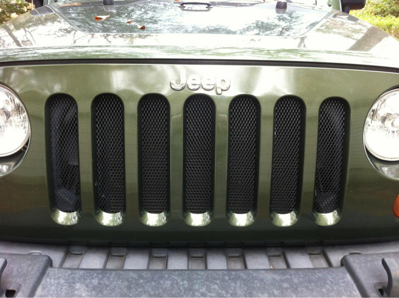

Knocked this mod out today.

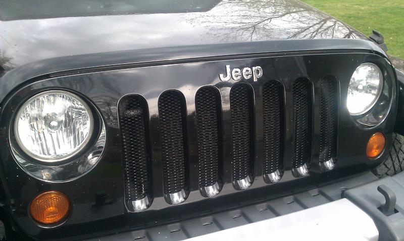

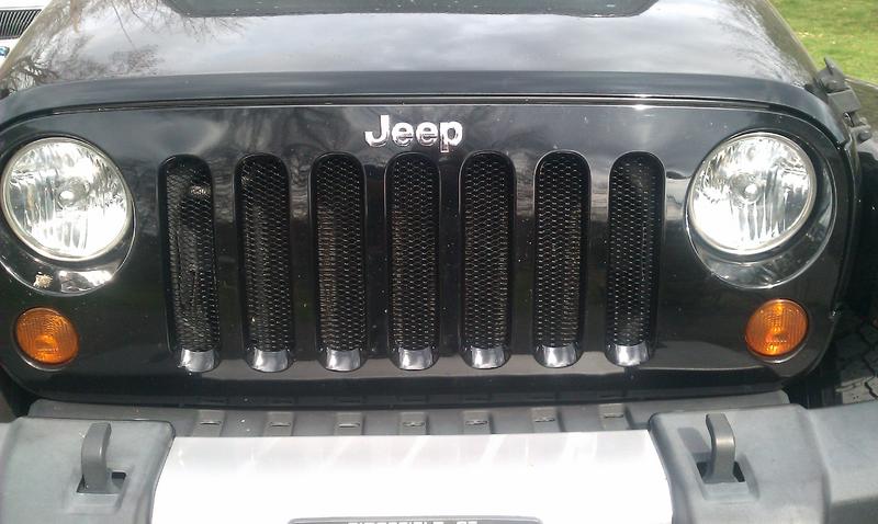

Did mine last month with the aluminum sheet from HD. used the tie down squares, tie straps with contact cement so far holding on strong...

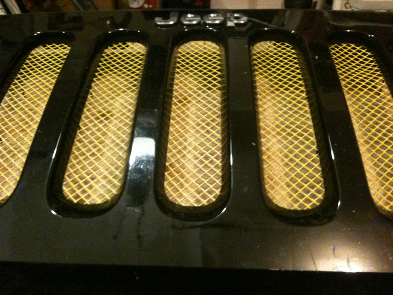

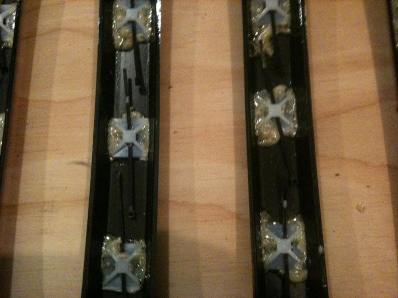

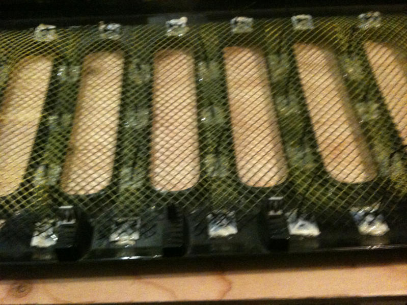

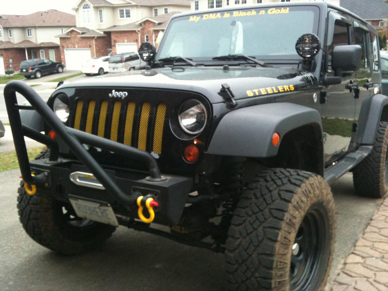

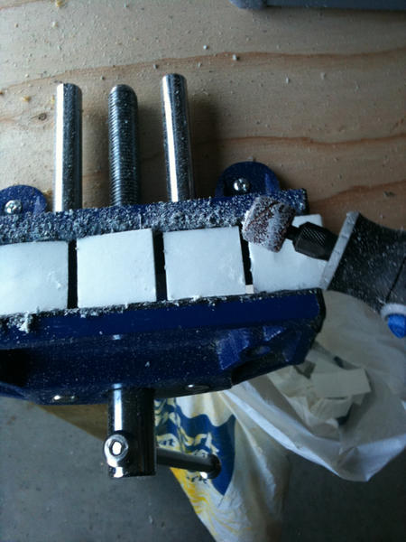

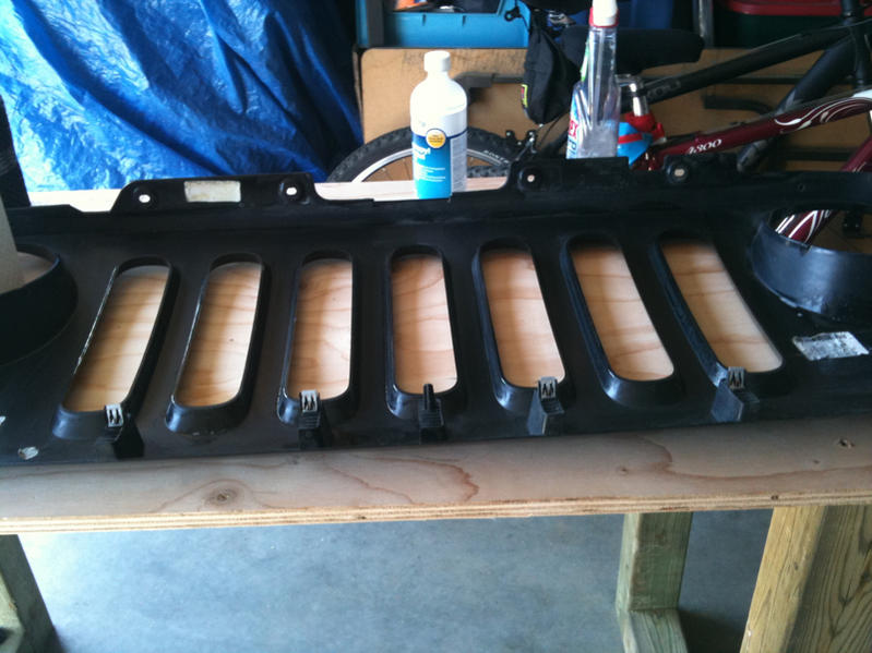

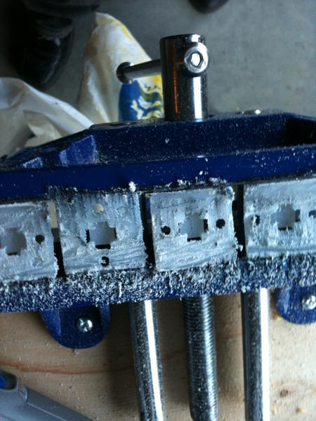

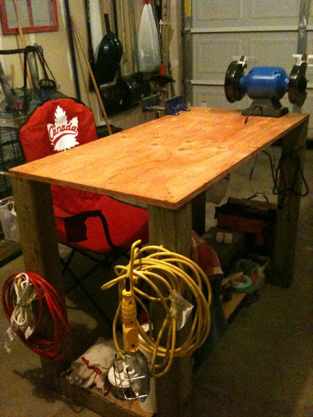

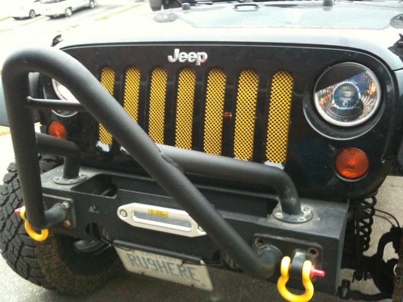

First built a workbench to do my grille mod...
tedious work but love the result!!
I actually used a dremel with a sand paper attachment to remove all the sticky pads off the zip tie blocks soooooo much faster. Also used goop contact cement glue for PVC,plastics etc on the back and for an extra security used gorilla glue on top of the blocks(that's why it looks messy) no one sees that side anyways. Painted yellow of course go Steelers!!
Sorry Iphone I downloaded the pics in proper sequence BUT it obviously didn't turn out that way lol
Is dremeling the zip tie squares a must do?
