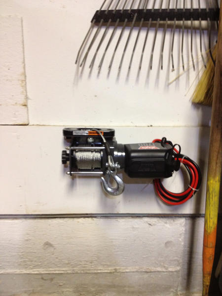

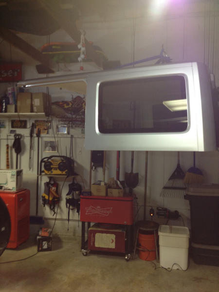

I drilled four holes in my top and used rubber washer. Warn 1700 winch on Amazon $99 shipped). About $30 in parts and carabiners. Hooked to old 12v battery I had laying around. Put silver vinyl stickers on my roof and freedom panel "humps" and I slide the freedom panels onto the roof upside down (vinyl to vinyl). Takes me less than 10 minutes start to finish, solo, to get my roof on and off.

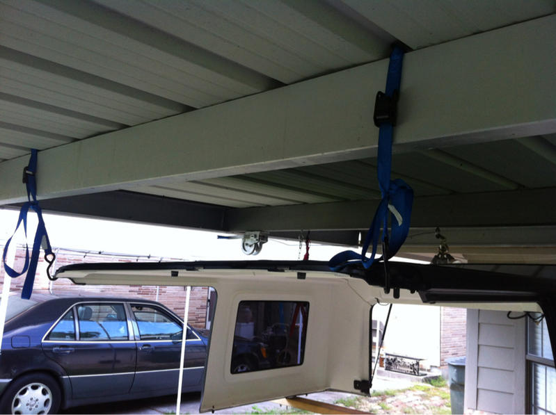

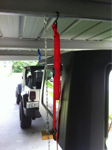

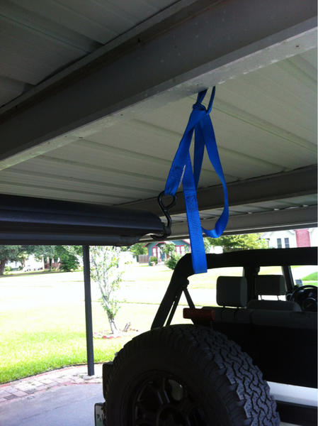

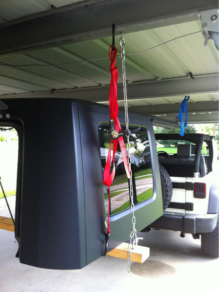

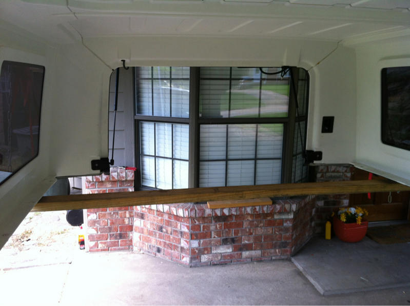

My simple rig. 4 ratchet straps, 2x4, chain and few eye bolts. About 20$ Takes less than 5 minutes with one person. Pictures aren't great but you get the idea. Really sturdy. Does not move hardly any once its secure
