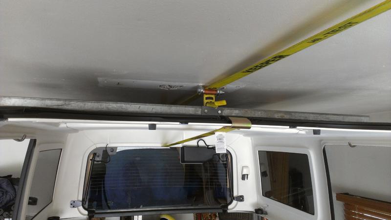

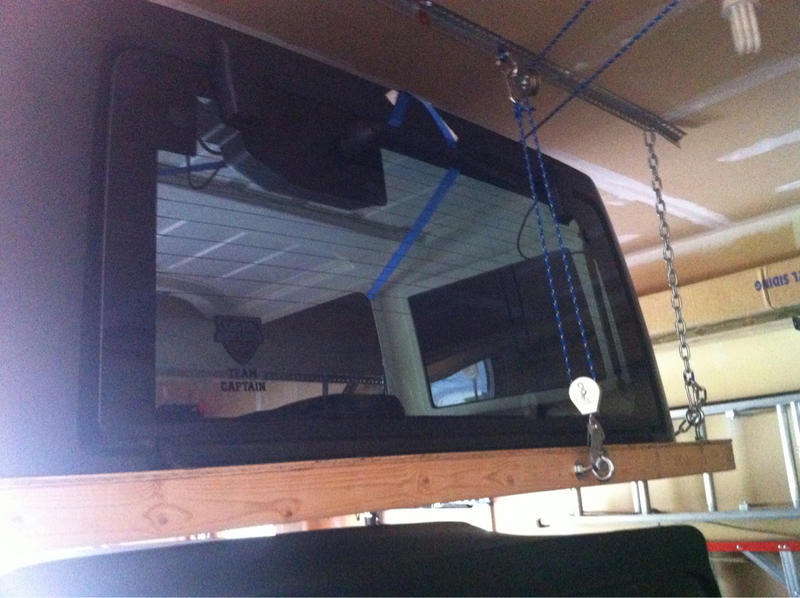

I don't have a good picture of this but I took a few today. Let me explain that I have a shelf that I store the hardtop on and that is how it is sitting right now. I feed the straps from the center of the rear window to each of the rear side doors (make sure you feed the strap on top of the roll bars!). I hook the straps to the three hooks that are suspended from the winch ropes. I crank the top up and drive the Jeep out of away. Then I hang the shelf from the chains and lower the top on to the shelf. Then I move the hooks from the straps to the shelf eyebolts. (I use some light cord to tie the straps in place so I don't have to run them again later.) then I winch the shelf as high as I can. This gives me more clearance under the Jeep then I could get with the t-bar and having the block and tackle between the top and the ceiling.
Here are some pictures.
The first one is a side view showing the top in the stored position.

Here you can see the straps tied into position. When I am lifting the top the strap is fastened to the hook instead of the hook being fastened to the shelf eyebolt.

here is a picture showing the rear of the top. Both straps meet in the center. It would probably work just as well to use four separate ropes instead of three like I have. I started with the t-bar, using the straps to fasten the top to the t-bar so I already had the V shape in my mind when I converted over.

Here is a closer picture Sowing a good view of the straps inside the top.
