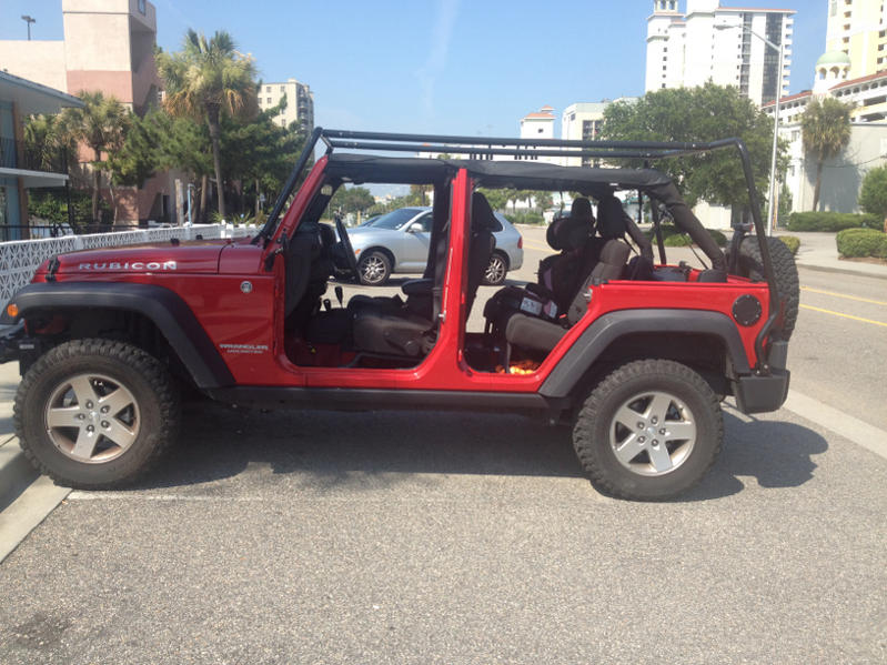

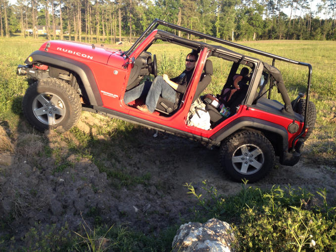

I haven't read this thread in awhile. I don't know what all has been said but this is how mine went less than one year ago: I odered mine from 4wd and it took forever to get here. It ships directly from KM. I was so excited when it arrived. Then I realized it didn't have the frame mounts or hardware. After several conversations with Marssel? I finally got the rest of it. It (JKU) doesn't have any risers for the soft top but it clears it. I had to get a couple of different bolts to mount the frame supports on the back as nothing in the kit seemed to fit. The install was very easy except for lining up the front tubes with the windshield mounts. They didn't seem to lineup quite right. I later realized that smaller washers would alleviate the problem.
All that said, after I got it on, it is awesome. It takes a few minutes more to take the top down as you have to remove the font two bolts. I would do it again.Click image for larger version

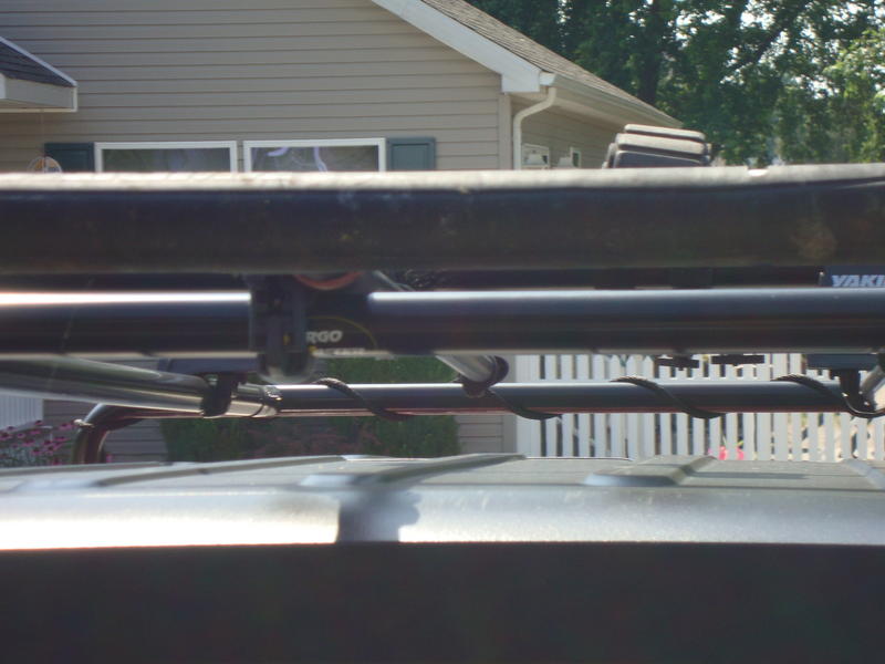

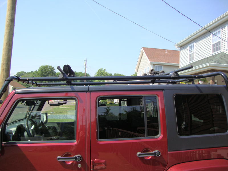

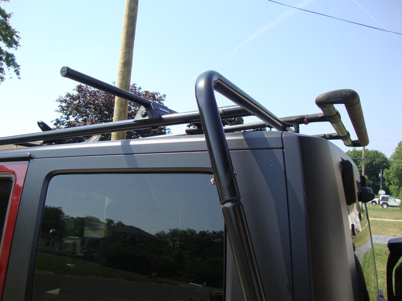

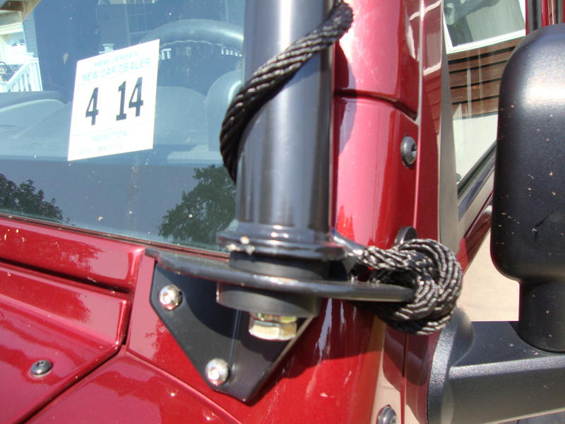

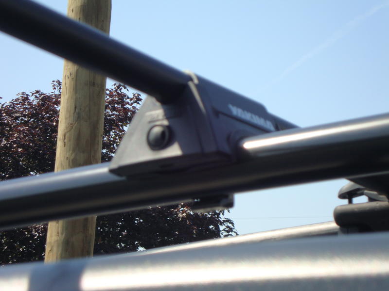

ID:	332156Click image for larger version
ID:	332157Click image for larger version
ID:	332158Click image for larger version
ID:	332159Click image for larger version
Should give you a better idea of gap between rack, crossbars and roof as well as the mounts and such. Good luck !
