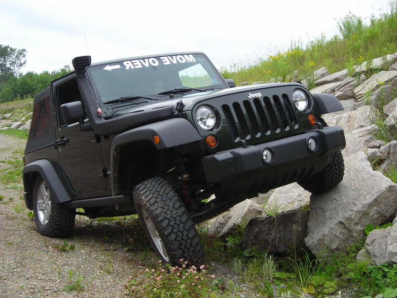

Finially got arround to doing this, took my time, about 1 taped everything as it was from the factory, used marine water tight bullet terminals and they fit inside the plastic wire wrap. Dam and I had bought a six pack.
thanks to everyone who posted and made this so simple. Tucker dog really couldn't care less, he was just happy that it didn't take to long, more time for swimming.
