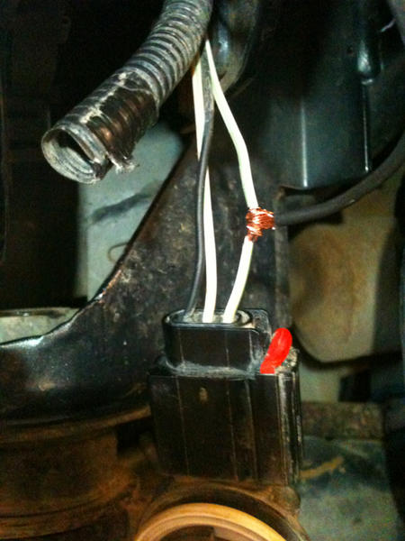

No offense taken. As I said, that's the way it is hooked up currently. Black to outer most wire. But my fenders are chopped and I'm hooking up a 12v LED replacement- would that make a difference?
Pretty sure this doesnt work with LEDs, at least not without further modifications. Read back thru the pages, pretty sure others had the same problems with LEDs

So I just did the turn signal mod on the passenger side. I cut the black wire from the marker and bought a tap connector and connected it to the outer most wire farthest from the black. So as soon as i do this the turn signal does not work. but if i disconnect it the turn signal works.
Any help would be greatly appreciated!
By the way I have a 2012 rubicon unlimited....which sounds like it is supposed to work on the 12 since others say it works....
Edit: Figured out what I did wrong. Cut the wrong part of the black wire. Had to add more wire, at least I only messed up one side. But its working now and I'm happy!

I performed the mod on my 2012 yesterday and it work great. On the left side I connected the black wire from the side marker light to the White/Brown wire to the front light. On the right side it was the black wire from the marker light to the White/pink wire on the front light. In both cases it is the wire on the outside opposite the black wire. If you need a photo I could take one.
I cut my marker light wires way up near the connector located behind the headlight, and then tapped into the other wires up under the wire loom. I soldered the connections and put the loom back over it and it looks nice and neat, and the splice is covered over by the wire loom.
I did notice that when I was wireing it up, and I tried to test it, it will not work if you have any of the bulbs unplugged. I had the front running light unplugged, and wanted to see if the marker lite was wired up correctly and it did not work, until I plugged everything back together.
