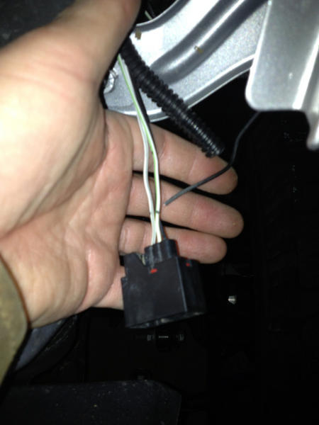

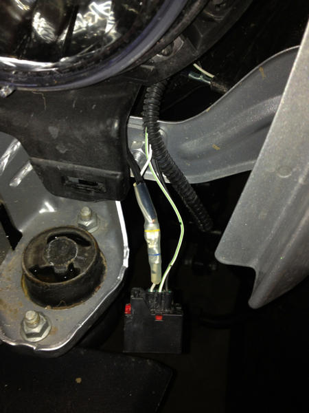

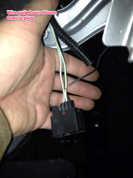

To add my two cents, DO NOT CUT THE WIRE NEAR THE BULB. Cut it at the other end, near the connector up behind where the front running light is. Then extend that wire or just pull it out of the flex loom and bring it right to the marker wiring to tap into. On my 2012, it was the wire furthest from the black wire on both sides. I used marine grade waterproof heat shrink connectors on mine, after extending it (Molex Perma-Seals - 2 wires into one wire connector). I extended it so that I could have it run out of the end of the flex loom, for fear it might chafe if pulled out of the side of the flex loom. But I'm super anal about these things! Btw, taking the grill off made all of this a lot easier.
