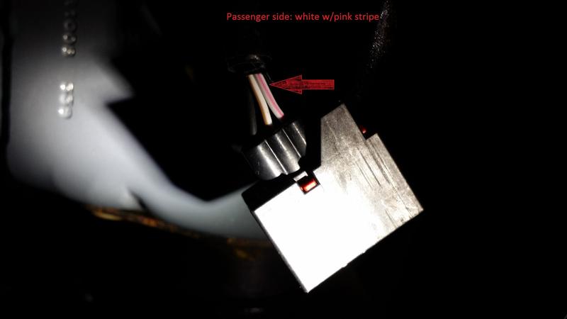

Old Apr 15, 2014 | 04:31 PM
  #578
enzo319's Avatar
Joined: Mar 2010
Posts: 206
From: OKC
These are the wires you need to splice into
ID:	546009   Click image for larger version

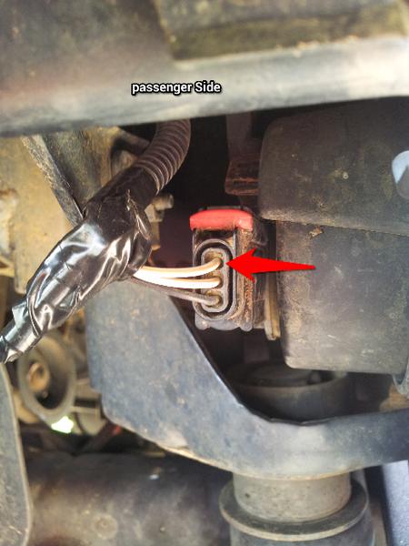

Old May 3, 2014 | 06:30 AM
  #579
Mangrove Mafia's Avatar
Posts: 209
From: Tampa, FL
Based on one of the above posts, comments on that YouTube video say it won't work on a 2014. Has anyone confirmed this? I went out to take a look at the wiring, and everything seems to be the same, with the exception of different colored wires now being used (different from driver to passenger side as well).
ID:	550271 Click image for larger version
Old May 3, 2014 | 12:08 PM
  #580
ShutterBug's Avatar
Joined: Sep 2013
Posts: 1,636
Likes: 7
From: Mentor, OH
I did the mod on my 2014, and I wish I can tell you exactly what I did, but I did it at the same time I put on Bushwacker flat fenders, which now makes those wires nearly impossible to get to anymore.
I did notice one thing, however that kind of aggravates me. I tested the wiring on the driver's side with the factory bulb. It worked as expected. But since the Bushwacker uses LEDs, and they are polarized, they come on as markers, blink when the lights are on, but they don't blink when the lights are off. The passenger side was a little more difficult to figure out, and I used a probe to determine which wires to use.
I think if I were to ever open it back up, I might install a diode bridge rectifier on the wires and it may solve the issue with them not blinking when the lights are not on. I run with my lights on whenever I am moving, so it's not a major issue for me.
