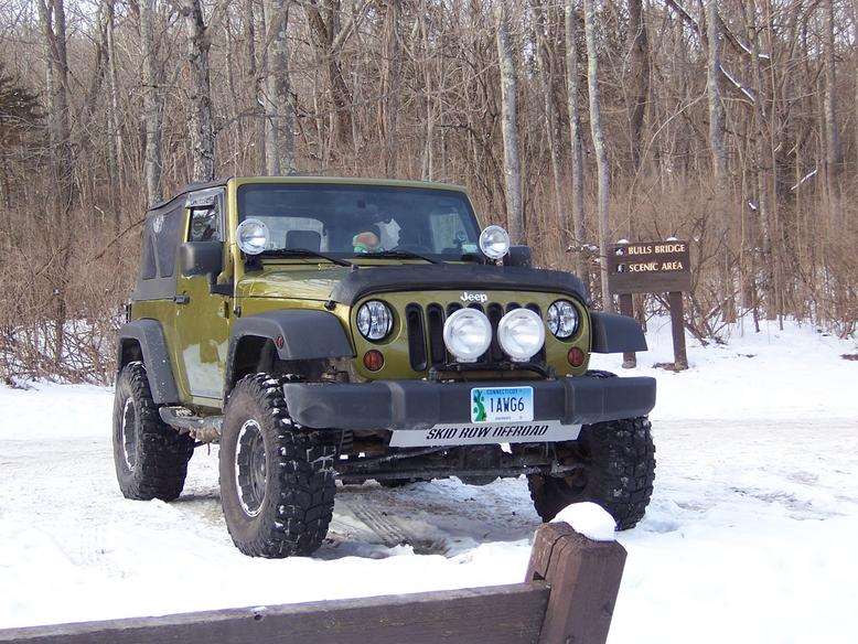

Default skid plate
Originally Posted by JK-KJ
Yeah, I need to get one...I know they're not that expensive. You got a pic of yours?
the skid plate is great and super easy to install. Here is a pic..
Man, I don't know how long it's been since I posted that but I've had mine installed for a pretty good while now....it even fits on the new bumper...
