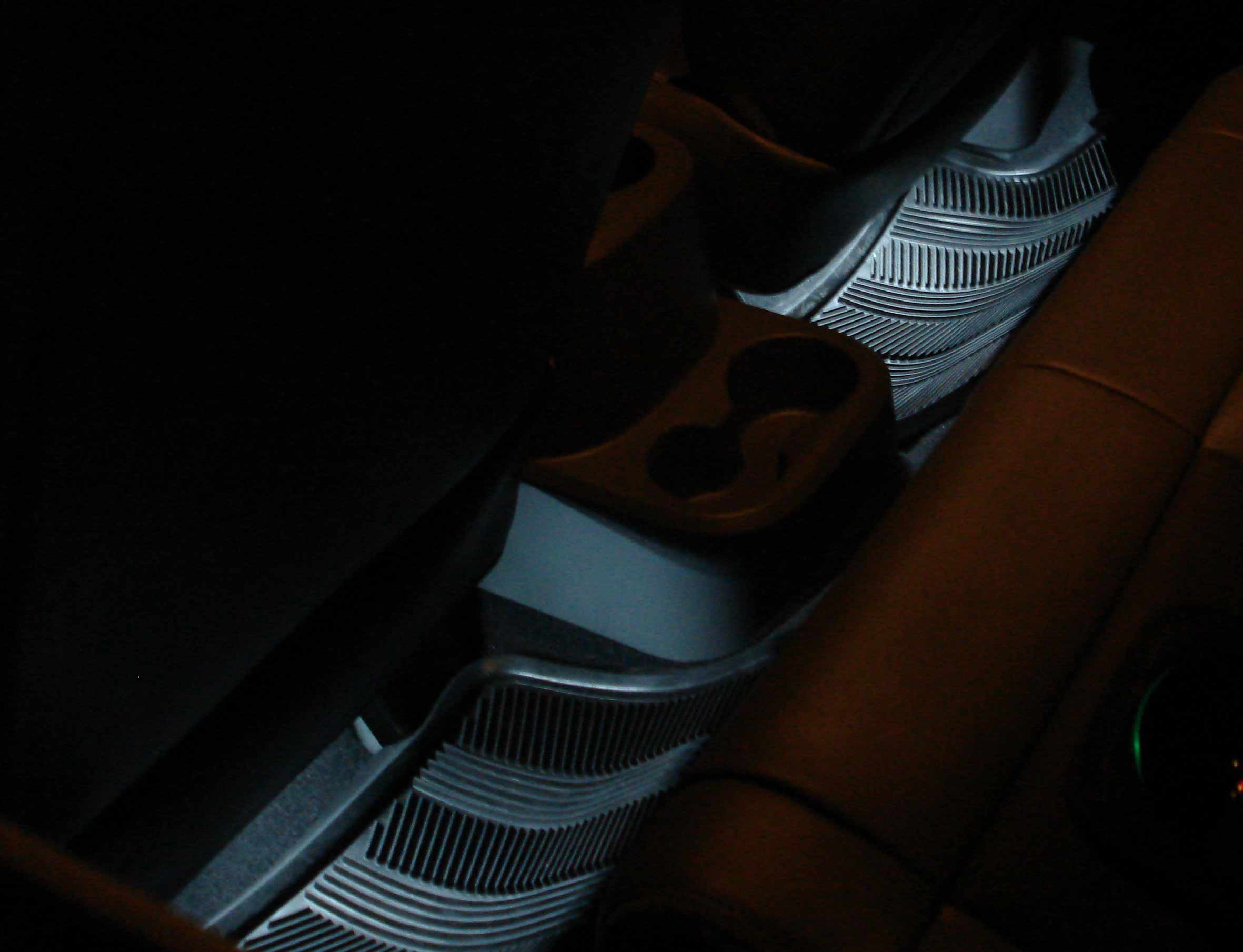

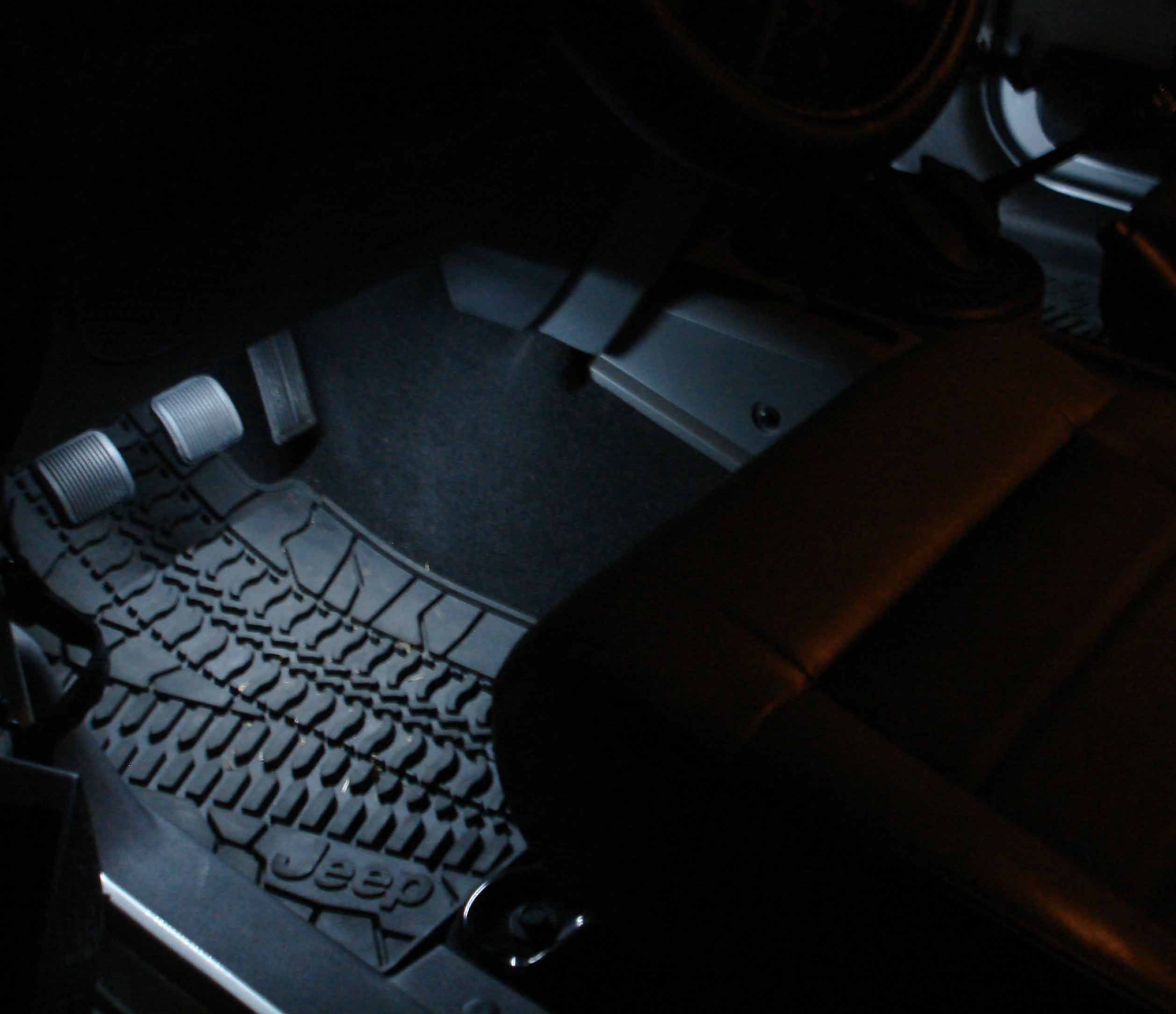

Here is the lighting that I installed today. Mopar lighting is $267, I paid $27 shipped for all four lights and installed in about an hour. Hooked them up to the dome light so I didn't have to worry about a switch and they dim out with the dome as well. Bought the lights from the 'bay and cut out the little controller that came with them so I could get them all to light the same. 18 LEDs per bar x 4 bars.
