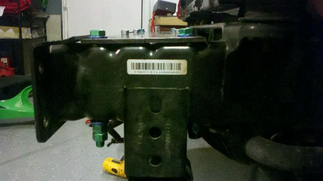

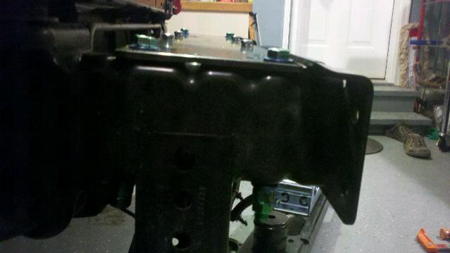

When the winch plate is bolted to the jeep, it looks like you used two bolts per side. I assume you had to drill through both the plate and the frame.
How did you attach the bolts? I don't recall seeing access to get tools up into the frame area. Or, did you thread the holes in the frame to accept the bolts? Please share!

The winch mount plate from harbor freight that I used already had the holes drilled in the plate but yes I did drill through the frame. I used four grade 8 to mount the plate to the frame and I cut a small slot on on the end of the frame rail to allow a box wrench to be inserted. There are holes there already I just enlarged one of them. Worked great and has held up well. Sorry I didn't take pictures as installed.

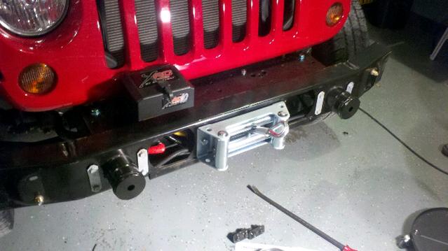

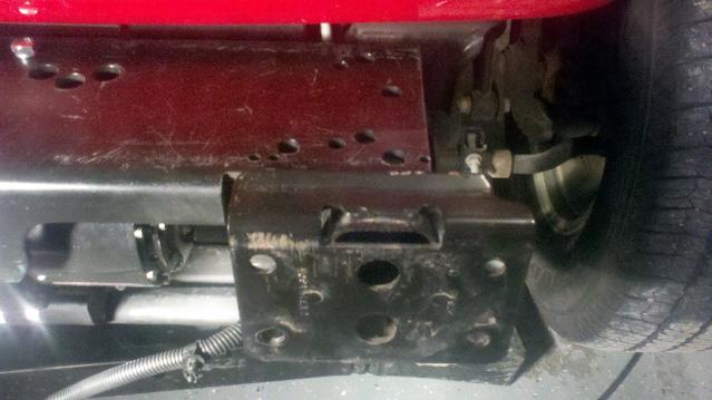

I did the same thing. I used 4 6 inch grade 8 bolts so they went all the way through the frame. Ill attach some pics so you can see what I did. Hopefully these give you a good idea.

Got a "universal winch mount plate" from amazon here in Germany.
Little cutting with the angle-grinder. i turned the knob for free spooling up, so i have comfortable access from above
Solenoid is under the hood and i have a remote control too, so everything ist fine
