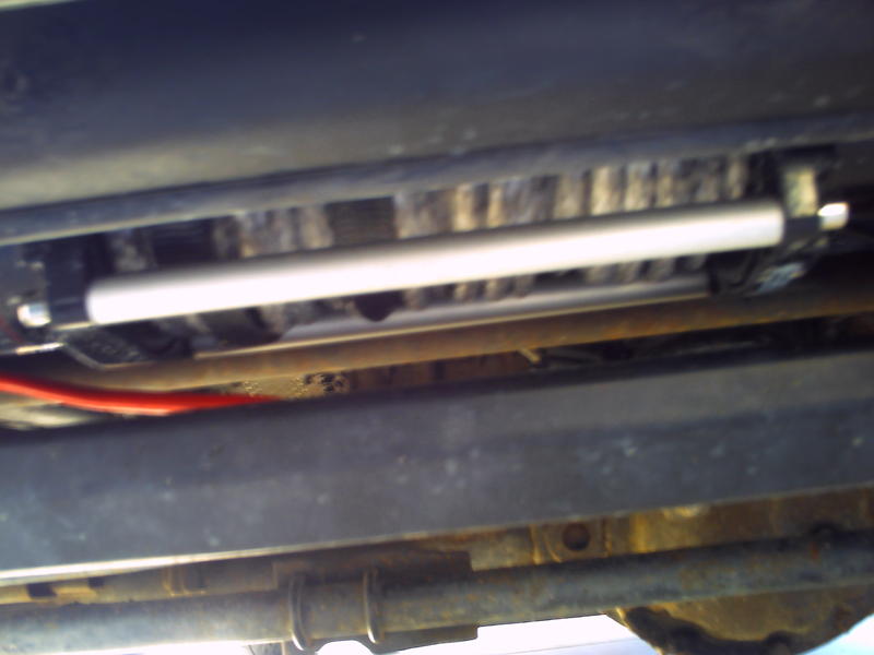

Anyone tried this install with an intergated winch? I have a Warn 9000i, its not here with me (just moved to norcal from mass) so I can't measure the height of it to determine if it would hit that lower crossmember.
Thanks for the help, mostly just wondering if its worth it to ship it out here or just pick up something else with an external solinoid.

A winch with an integrated solenoid that you can't mount externally out of the way, i.e. Warn XD9000i, 9.5ti. I don't have the winch with me and need to know if it's too tall to run upside down due to the front crossmember. Trying to decide if its worth it to ship across the country.
ht tp://www.cabelas.com/winches-recovery-accessories-warn-xd9000i-winch-1.shtml?type=product&WT.tsrc=CSE&WT.mc_id=GoogleBa seUSA&WT.z_mc_id1=747232&rid=40&mr:trackingCode=C7 8F9052-F5D2-DF11-82EF-001B21631C34&mr:referralID=NA[/QUOTE]
This is a pic of my Smitty 8000 and its pretty slim. I dont think you could mount anything as big as that warn without cutting the cross member out. even then your solenoid would be open to getting smashed.
Thanks for the reply, and the pic! This is sadly what I thought, guess I'll sell the xd and get something else.
