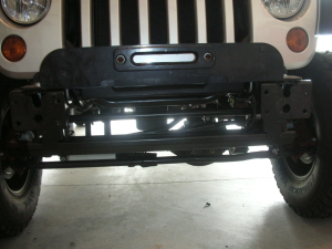

I have the same 2 dr rubicon, did the anti sway bar disconerct get in the way, also can you please post some more pictures, possibly from underneath, maybe without the factory splash guard thing, it comes off very easy, do you kkep it on to keep the winch clean?

No the sway doesn't come into play as a problem. Look back a couple of pages and you'll see mine. You just have to plan it out well and it's clears by and inch and a half.

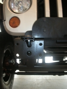

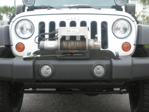

Followed the directions from the first guy who posted this....with a few variations along the way.

Here we are. I had the WARN winch plate from my TJ. My cuts on the top of the bumper where a little differant. But all in all it worked.
Sorry not sure how to post so you don't have to open the link.
Dude, that looks good. Almost wish I kept my stock bumper on.....almost.
