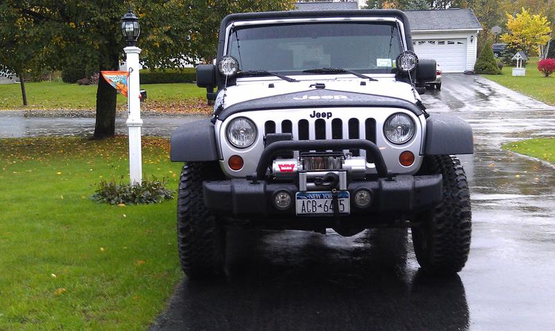

this looks like an amazing project. i wanted an aftermarket bumper that sat the winch down low like that. are you guys doing this as more of a weight savings over an aftermarket bumper or more of a cost savings? i would think the weight savings over an aftermarket bumper is considerable.
Old Jan 9, 2012 | 08:23 AM
  #272
Doctaco6's Avatar
Posts: 51
From: Baltimore
The weight factor is one that I never considered until I actually did this. Really glad i didn't buy some huge bumper, the winch alone is really heavy. But my primary reason was the cost effectiveness.

Originally Posted by JK RUBI REDROCK
Thats the plate i used work great and you cant beat the price! with the factory bumper i cut with grinder 1" by 4" off of the front corners stack 3 washer under plate per bolt in the front then it sits nice and flat with the frame.Attachment 223825
Where did you get that light bar on the bumper, love how that looks with the winch!

Originally Posted by jleadmon
Awesome idea! Looks great and clean/factory almost..
I have only one wondering question...
If you mount the winch upside down, isn't the winch exposed to that much more of the elements (snow, salt, mud, etc)?
I really like the idea of this mod, but the exposure factor makes me wonder...
I have a synthetic line and I would assume the mud, etc. would really wear on the rope.. not to mention the winch components too.
What's everybody's thoughts?
Discuss...
Well I don't play in mud, so it hasn't been a concern for me. All the other elements of rain, etc. won't hurt it
