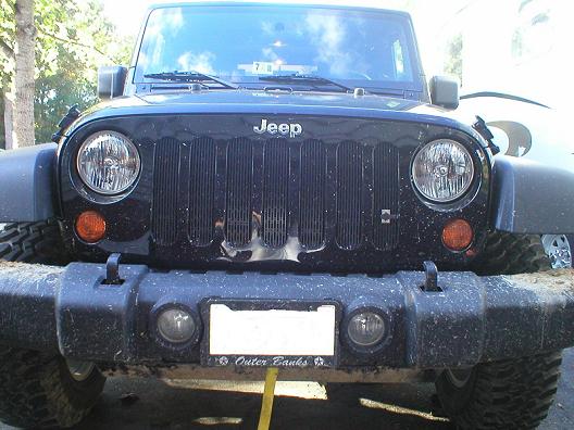

took the best out there and put on my twist . I wanted a stock looking front end which included the required front license plate Click image for larger version
Name:	with plate down .jpg

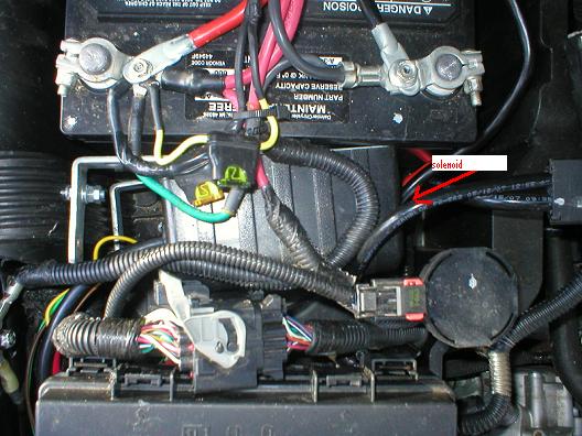

ID:	4015 (the area that look like a dent on the bottom of the grill is just the flash) I wanted easy access to the winch but didn't want to block the rad. with the soleniod to avoid a over heating issue Click image for larger version
Name:	with plate up.jpg
ID:	4016. I moved the soleniod beside the battery Click image for larger version
Name:	solenoid mount.jpg
ID:	4017 I ran new cables from the solenoid to the battery and winch. Auto part stores carry a large selection of battery cables with the right ends to hook up the battery to the soleniod and the soleniod to the winch. I used a trailer 4 wire wiring harness (removed 1 wire as its not needed) from the soleniod to the controlled hook up. I placed the trailer wire 4 plug hook up connection behind the grill to make the removal of the grill easier and place the controlled connection through the grill inserts to finish it off.
