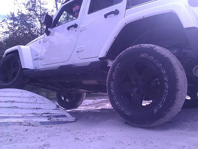

Just my 2 cents as a first time Jeep owner. I bought a 2012 Sahara Auto with 3.21s. Now that I am bitten by wanting to wheel every weekend, I would have done a few things different.
I would have still gotten the Sahara, but I would have opted for the 3.73 gears and the limited slip dif in the rear. As far as the auto goes, I love it. I have driven stick in other vehicles. keep in mind that this auto will hold whatever gear you put it in on the manu/matic mode. It will not shift even at redline. If I was you I would be tempted to go with the Rubi Auto with the 4.10s.
