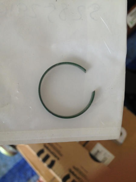

Thanks Jaker! One more question, where the heck does this C Clip go? Is it part of the shifter cable?
Attachment 471703
It goes on the out put shaft from the tranny and that clips goes inside the input shaft to hold the two together
Ok so it's kinda like sandwiched inside the output shaft? I'm sure when I get under there it will make more sense.
