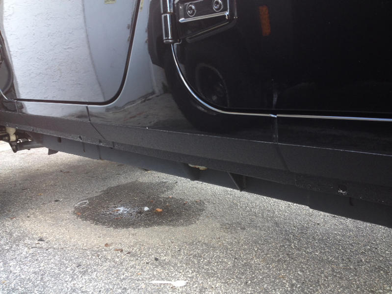

Yeh after talking to a few locals in some Jeep clubs and shops, everyone is in agreement that I should not need anymore lift.
Next will be a full set of adjustable control arms, just in case I decide in the future to add lift, and of course increase my off-road performance.
Also still need to need up the front D-30, will be changing the shaft to a chrome- moly and adding gussets. Most say do that first, but as long the stock are holding up, I see no reason to be in a rush to change it. Will also be adding new ball joints when I move up to the larger tires.
Stay tuned

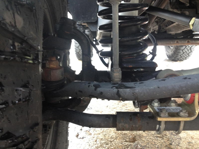

Well another step down in my quest for 37's, just had some EVO C-Gussets welded in. What a difference, you can really tell that a lot of steal was added in the area. Hear are some before and after shots. I apologize for the poor pic quality, but you can sure see the difference.
Before stock Dana 30.

Next step, having Nitro Gear axle sleeves and chromoly axles installed in two weeks.
Cheers

Exactly what I was planning when I was going for 37s plus a truss and ball joints.
C gussets look good. Congrats.
Id ditch the drop pitman and do a high steer kit also. It helped my handling a lot.
