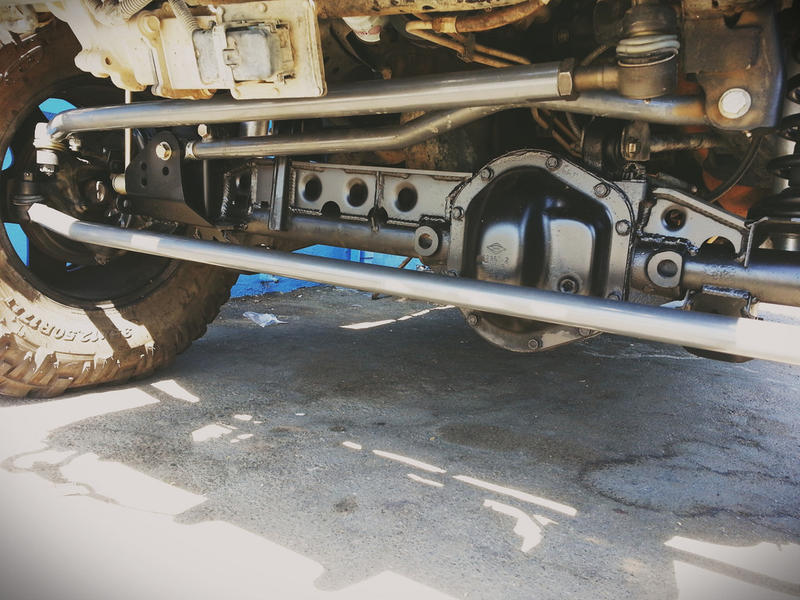

Start by taking a look at which components came with your 4" BDS lift. Are there any components that just might correct the steering angles? A raised trackbar bracket and drop pitman, perhaps?
In the case of the comments and picture from earlier today, the drag link was flipped to the top of the knuckle (as opposed to being lowered by your drop pitman), but the trackbar stayed right where it was (as opposed to being relocated by your bracket). So the bars in the pic started parallel to each other, and now, as we can see, they are not. (as opposed to yours that were both relocated and remained parallel to each other).
Just stole this pic from the Trackbar thread (thanks Trauma). See if you can tell the difference between it and the two D_engel quoted earlier...

  #44
TRAUMAhead's Avatar
Posts: 976
From: Cen Cal
Another shot showing the track bar and drag link being parallel.

Originally Posted by D_engel
Flipped link and stock trackbar brackets. Bet this thing drives like shit. No offense.
Hey guy your Jeep probably drives like shit, but no offense!!!! Really???? Maybe you could have offered some suggestions as to what is wrong and maybe a remedy. It actually drives pretty good; I have however noticed that I now have just a bit of bump-steer that I never had before. When I decided to get the new RK springs I knew I was going to gain some lift, that's why I decided to do the drag-link flip. No one informed me that I needed to raise the track-bar also and keep it in line with the drag-link.
Well after ready all these wonderful posts, from such helpful people (sarcasm if you did't notice) and sending Synergy some e-mails along with a photo of my current setup, I can say that. I have learned a good amount of info. I also have ordered the Synergy track-bar relocation bracket to address the issue.

Originally Posted by Anglico1
Maybe you could have offered some suggestions as to what is wrong and maybe a remedy. It actually drives pretty good...
In all fairness, you did give an initial review of the performance, with zero indications that anything was wrong.
Overall, first impressions on the drive home, very positive, I gained an additional 1.5 inches of lift, the ride on the road is mush smoother, and I would say the steering is a bit stiffer and more responsive.
Had you said something simple like:
you would have received the constructive comments indicating 'why' you are now getting the bumpsteer, instead of comments wondering how the steering was still good.
Attachment 577941
Thank you for the explanation, so that's what a gusseted axle looks like
Does it really make a big difference in the strength along that axis?
Matthew
That is a truss not gussets...
Thank you for the explanation, so that's what a gusseted axle looks like Does it really make a big difference in the strength along that axis? Matthew
When installed correctly the truss is stronger than sleeves.
