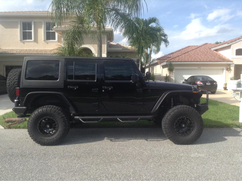

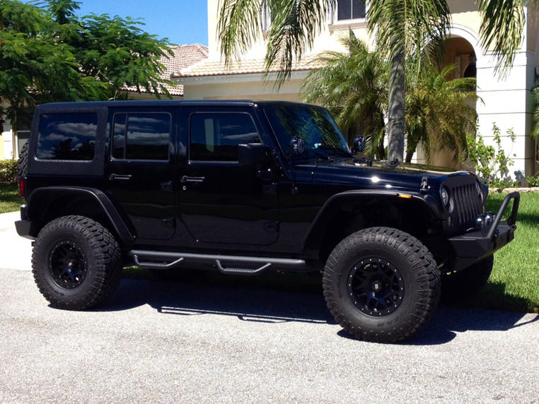

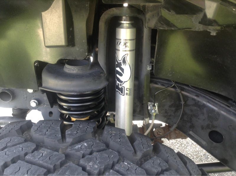

Well one more and final step down before I move up to the 37's. Just picked the Jeep up from 4 Wheel Parts Miami with some new suspension upgrades.
Changed out the BDS 3 inch springs with RockKrawler 3.5 inch springs, changed the BDS shocks for FOX 2.0's, got rid of the SkyJacker dual stabilizer and put in a FOX ATS, added a Teraflex flipped drag link and added some Rubicon Express stainless steel brake lines.
Overall, first impressions on the drive home, very positive, I gained an additional 1.5 inches of lift, the ride on the road is mush smoother, and I would say the steering is a bit stiffer and more responsive. Here are some photos of the new goodies.
JK BEFORE THE NEW SPRINGS
JK WITH THE ROCKKRAWLERS
SHOCKS

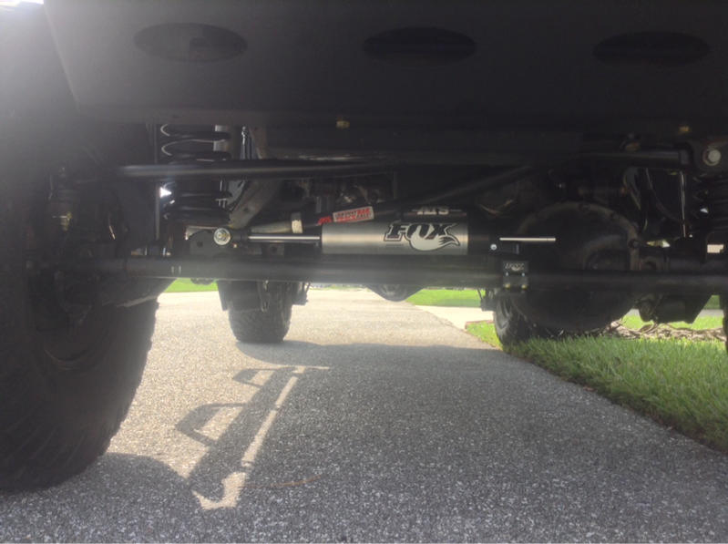

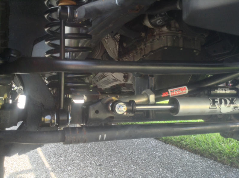

ATS AND FLIPPED DRAG LINK

Originally Posted by Anglico1
.. added a Teraflex flipped drag link
Attachment 577782
Attachment 577783
Flipped link and stock trackbar brackets. Bet this thing drives like shit. No offense.
Old Sep 30, 2014 | 05:29 PM
  #40
nthinuf's Avatar
Posts: 11,463
Likes: 165
Yeah, I was wondering about that also. How does is not have a ton of bump steer with those angles.
