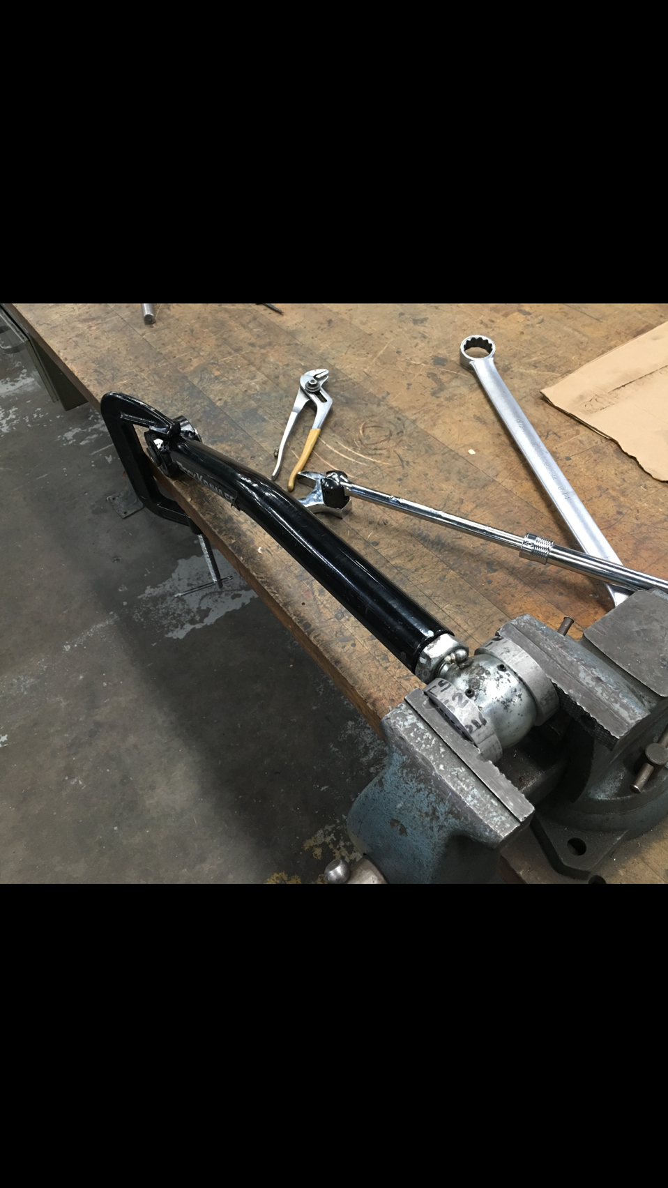

Originally Posted by kjeeper10
Crows foot and breaker bar
I figured I resurrect an old thread due to having to tighten my LCA jam nuts.
I didn't have a Crows foot but I found a very similar method that worked for me.
Bench vise + C-Clamp
Then tightened down with a pipe wrench with a long pipe from my floor jack.

Originally Posted by Rednroll
I figured I resurrect an old thread due to having to tighten my LCA jam nuts. I didn't have a Crows foot but I found a very similar method that worked for me. Bench vise + C-Clamp Then tightened down with a pipe wrench with a long pipe from my floor jack.
There you go. The 2nd time around i used a c-clamp and spacers i made for the vise.
