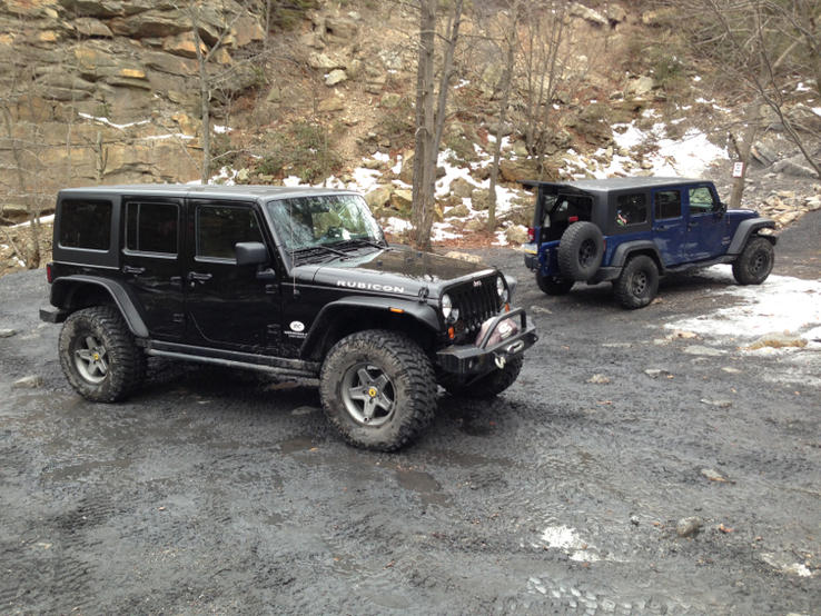

Just installed the 2.5 AEV last weekend and I still have some rake. Not bad but noticeable. I am running a heavy LOD front bumper with winch so I guess that's expected.
