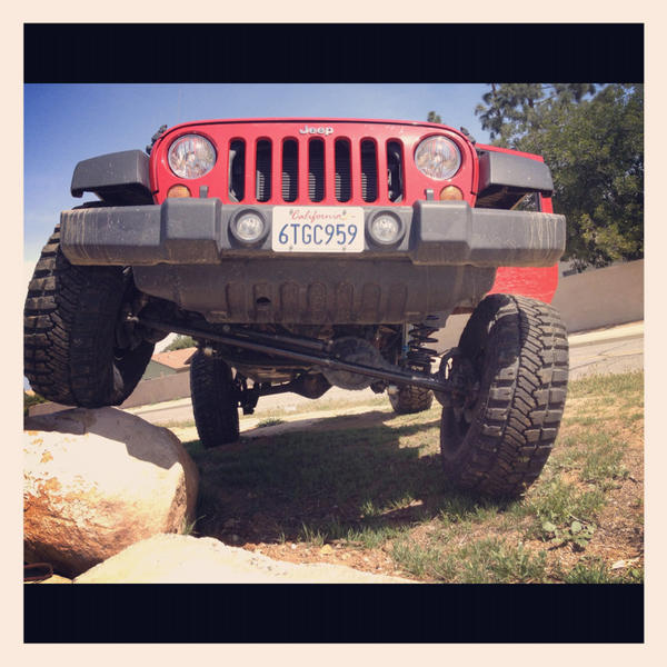

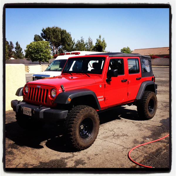

FlameRedJK's Avatar
Location: Riverside, Ca
Posts: 1,367
I'm Rock Krawler all the way!
If you want to run 35" go 3.5"!!
My 2012 with 35" MTRs and Rock Krawler 3.5" X-Factor with Ultimate High Steer Kit...essentially the Max Travel Kit
