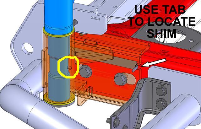

I saw that, but what is the zerk fitting? and how do i know which way is down on it?
You get a 90° zerk and it goes on the spindle for the tire swing. You need to make sure the zerk points down so you have access to grease it from under the Jeep.
any chance you have a pic of this?... sorry.. installed?
See the attached picture...the zerk will be installed into the yellow circled area and provides grease to the spindle housing. Once you reinstall the factory plastic bumper, access to this zerk is a bit difficult which is why it's important to point the zerk downward.
Attachment 147483
Thanks.. Installing thsi weekend, if I have any problems. I may hit you up for some Q&A if thats alright?
