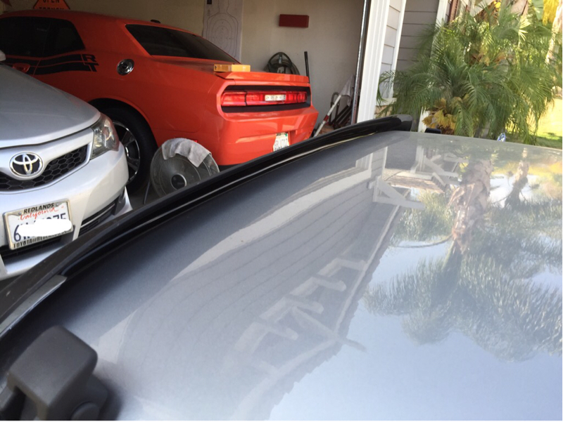

Originally Posted by itr.#1446
Do you have any up close pics you could post?

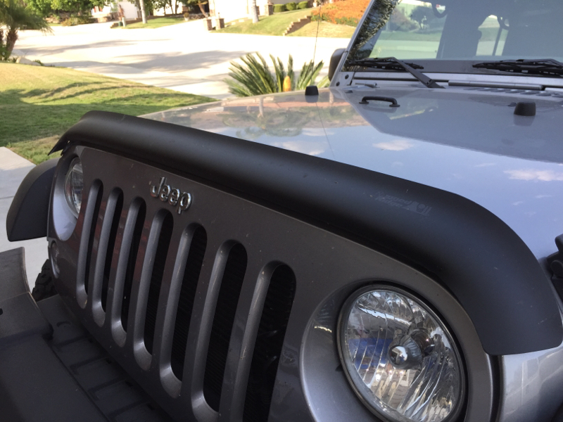

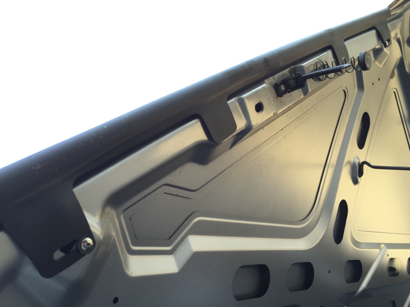

ID:	648469 far edges are screwed into the metal. Two center pieces have the 3m tape that's provided with the kit.

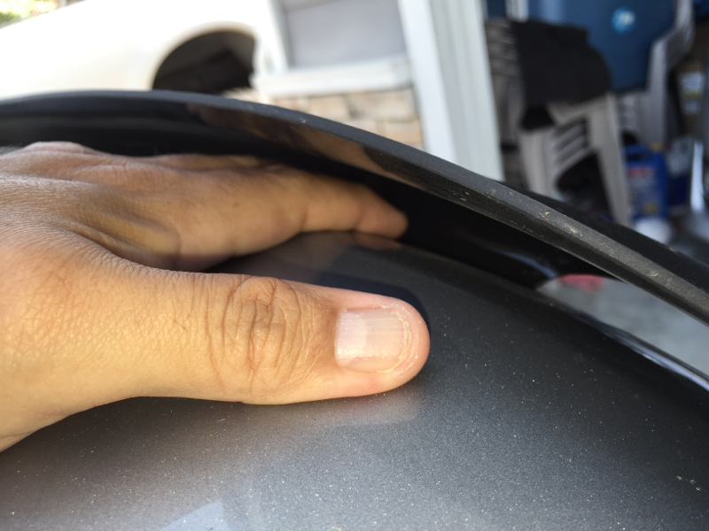

ID:	648470 Plenty of room to wash dry or wax if that's your thing. Fingers reach all the way to the end of the hood.

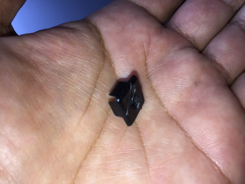

ID:	648472 these are the nutserts that come with it as you see they are stripped. Toss them in the trash and go straight into the sheet metal. I used pilot holes first. Ez.

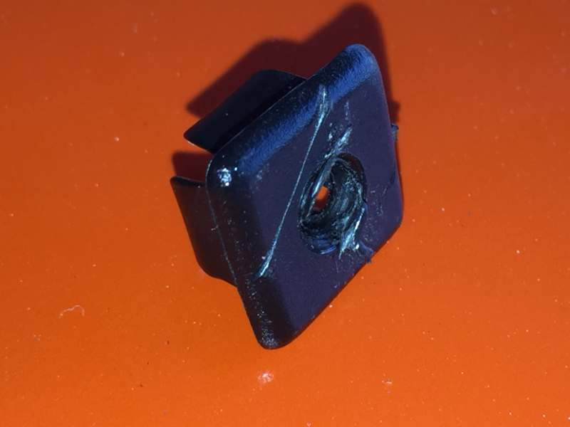

This is the weak link. Toss'em.

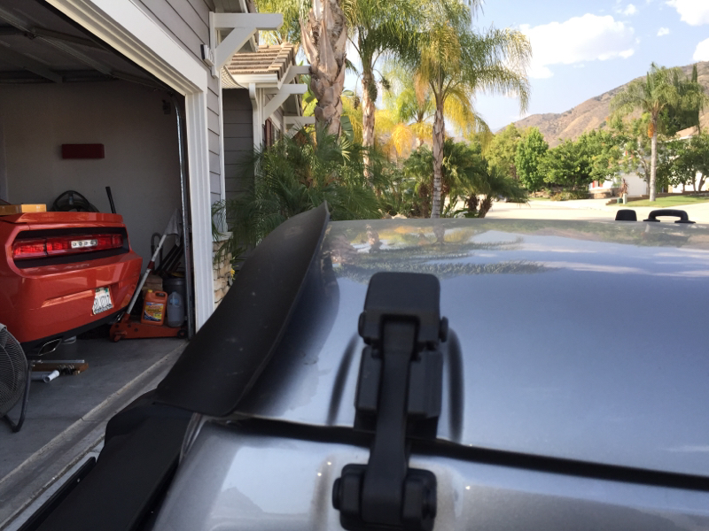

Old May 31, 2016 | 04:25 PM
  #40
pitbull62's Avatar
Joined: Jan 2016
Posts: 111
From: Redlands, Ca
the angle is what does the trick IMO.
