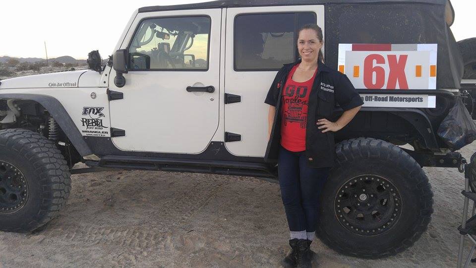

Originally Posted by TweakJK
That looks good. I see you were fighting the "jk lean" a little bit based on that last picture.
Do you have any ride height pictures with wheels on?
This was our trip to the Baja 1000, some gear in it, but this is where it sits. The wife wouldn't let me drive..
