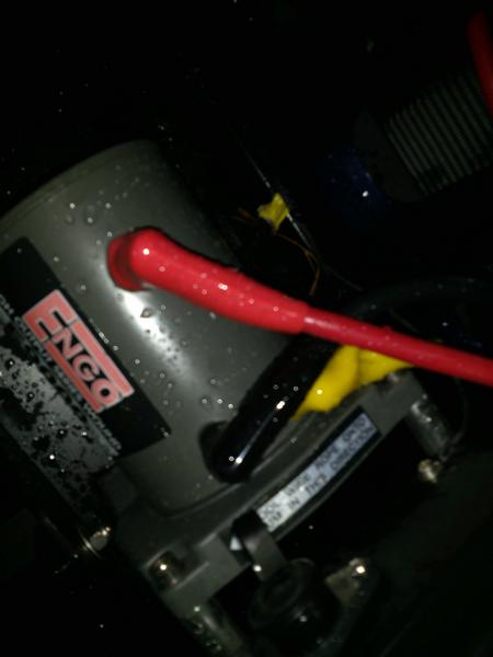

So I'm mid install as I write this. Everything is wired up, so I think, but have one question.
Where does the long, bigger black cable run from the battery to?
Does it run from the battery to the ground wire on the bottom of the motor that was such a pain to get to or one of the connections on top of the motor?
I'd love to get this installed tonight so any help would be appreciated.
Old Jan 6, 2013 | 04:34 PM
  #23
mattgt5's Avatar
Posts: 4,406
From: Gray, GA
The big black one goes on top like this
Old Jan 6, 2013 | 04:37 PM
  #24
BossHog's Avatar
Posts: 490
From: Jackson, MS
<img src="https://www.jk-forum.com/forums/attachment.php?attachmentid=406454"/>
That's from the battery to the top of the winch motor?
If that's the case, there are actually two black cables on that particular terminal (one from the battery and one from the solenoid box)?
Old Jan 6, 2013 | 04:56 PM
  #25
mattgt5's Avatar
Posts: 4,406
From: Gray, GA
You're right. My apologies. The black wire from the battery and the thin ground wire go to the contact on the bottom. The wires from the solenoid go on top
