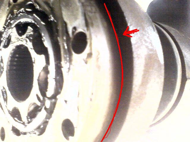

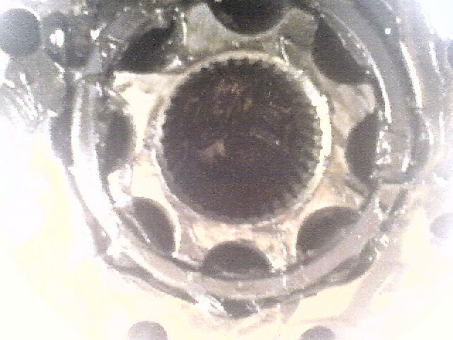

ok that was pretty helpful but how do I get the first part of the flang off that connects to the driveshaft heres a pic..
I need to pull that sprocket off with the first flange.
2nd pic is called the prop shaft and the dealer ship won't tell me how to take it off. that part for ne1 that breaks it is 317bucks

ttt new pics, talked to Donavee Jeep and there service tech would actually help me he said I need a special puller from Snap On

He wanted to talk to you, to ask if your a douche. For doubting him. Speaking on his behalf he has probly done more gear swaps then u will do in ur life. What kind of axle puller are you using to remove the Prop shaft from the pinion yoke see pic 2 ^^ above in my 2nd to last post

OK. Let's call a truce, OK? No need for name calling. I used an axle puller that functions very much like the one wayoflifette showed in the pictures. Now let's be clear on what it is that you are trying to remove. Did you remove the 8 (I think there are 8) bolts that connect the drive line to the rear pinion flange? After taking the bolts out, I had to do some "persuading" with a dead blow hammer to get the driveline separated from the flange but I didn't need any special tools. If you have this off, then you should be faced with the pinion flange removal. By looking at your pictures, I am concerned that yours came apart where it wasn't supposed to.

Truce is ok with me, just dont appreciate you acting like my friend doesnt know what he's doing(neither did he thats why i put he wants to know if you were one). I removed the 8bolts from the Prop shaft where the driveshaft goes into the splines. There is a C clip that keeps the drive shaft it the Propshaft that came off maybe thats why there not coming off together and you see the inside splines where the shaft goes into the prop. I dont see how you used a axle puller to get that off the Pinion. thats where we are stuck. We cant get to the bolt to remove it and use a deadblow to knock it out.
