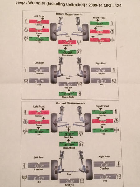

Croce and watson190, where are your alignment sheets?

I didnt get an alignment check, i just centered the steering wheel and corrected the toe-in.

Hope this helps. I have no idea. The shop said everything looked good.
Your castor looks pretty low, you have a 21/2" lift.....
yeah, just the teraflex budget boost with shock extensions. Would low caster cause a pull to the left????
