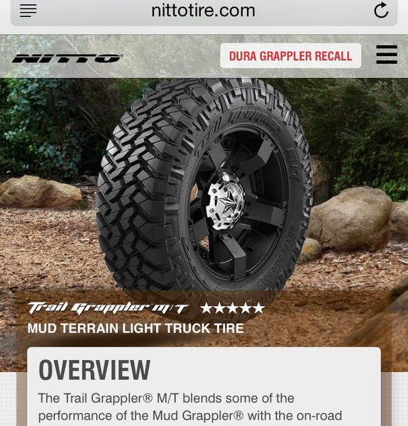

On their website nitto's pictures have them triangle out
