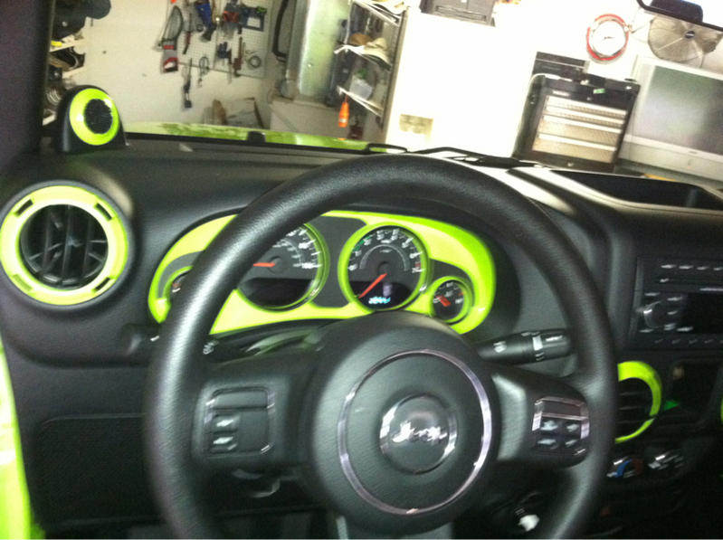

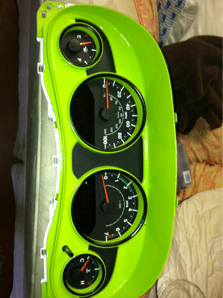

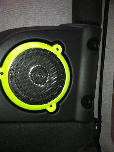

More painting. I swear once you start you just think of more stuff to do. Got rid of chrome trim in gauges with a flat black and the rest gecko!

Hey FyreFighter. How hard is it to take the gauge cluster off? I'm a little hesitant to do this. Any info is greatly appreciated

Easy take off cover below steering wheel first. Then below cluster on bottom corners should be 2 bolts. Take them off. In between my air vents I have the little tray. Pulled it out and was bolt behind also. On top of dash where you can store stuff. Lift up tray another bolt. Start prying from any corner. 4 bolts on gauges is another 4 bolts. Back of gauges is 3 wires unplug. And remover clear cover and enjoy. Hope it helps. Btw this is for 2012 jk. Shouldn't be to different for you

Awesome. I'm gonna order some spray cans and get this done. How many coats of paint an did you use a clear coat. Also any scuffing or sanding?
