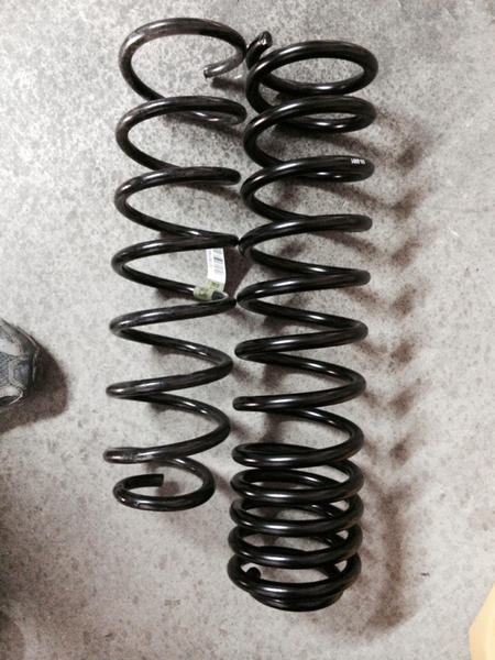

Anyone have measurements of the 3.5 coils? These aren't THAT much longer than stock. Pic of the front coils.
Just checking since I know some were shipped 2.5 coils instead of 3.5.

You can't go by comparing them. Look at the bottom winding on the stock coil (end code) you loose 2-3" installed in the jeep.

The metal cloak will also compress less then the factory coils when installed due to the increased coil rate.
