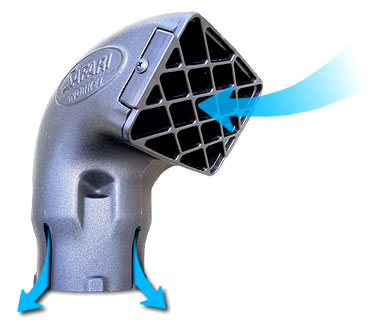

I've heard that you have to take a snorkel off when it rains or water will get down into your engine. Any thoughts?

A lot of people with the ram air snorkles turn the intake around when it rains.
Big negative. There are weep holes at the bottom of the ram air head that allows any water to drain out. I've driven through several heavy storms and checked the air box when I got home, dry as a bone.
The Rugged Ridge one has a drain valve.

Clearly, you want to extend your breathers with a snorkel, or without one. I did a write-up
LINK ->https://www.jk-forum.com/forums/jk-w...al-2dr-246787/
Then your going to want to seal the drain holes, in your air box, with some silicon. I think I would add a duckbill drain on that step. They don't let water in but let it out. It's shown on this thread ->https://www.jk-forum.com/forums/jk-w...-drain-249620/ . In all likely hood it is over kill.
