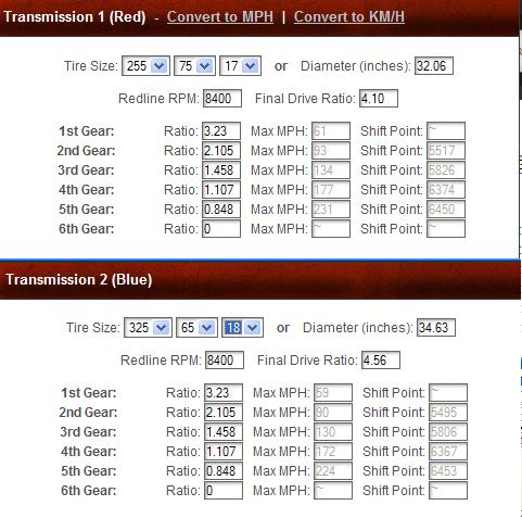

I hope the below chart can put this issue to rest. check out the RPM ranges between the two different tires sizes and gears. I cant speak for Auto's but I dont know why it would go into Limp Mode. ITs an almost identicle set up.

I see what you are saying. Most people that I know, use the Procal to accurately calculate fuel consumption. This seems to always be they talk about when they discuss the procal. The ultimate gear you choose is totally dependant on driving style and dirving conditions.
That being said, the only point I was trying to make is that for the 2007-2011 4:88 is the "typical" gear selected when adding 35's. Its different for the 2012 and later however. Where a person would use 4:88's, 4:56's are now that gear.

Also it seems to me that by this chart that with 35s you should run 4.88s as it will put you just a hair under what a Rubicon's Rpm runs at stock. Is that correct?
Thanks

Gotcha, ok I was looking at the wrong tire size than the Rubicon has on that chart. oops.
Should I bump up to a 4.88 or would a 4.56 suit me just fine? This is my daily driver and it will not be going bigger on tires until my new axles are finished. I am still running the Dana 30 up front and don't wanna weaken it by going too big, as I have heard a 5.13 will do just that.
