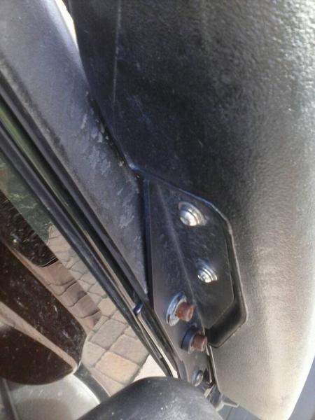

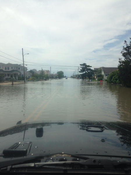

ive left it froward no worries, there designed for it. When i used to fit in car washes i took it thru there also. Seems weird if your "snorkel" took on water in the rain. spinning it around is probably more safe, but i never have.
Granted this happened during a major storm and downpour that flooded the whole island 3 feet in 30 minutes
And I was driving in it kinda expected a little but was surprised how much came out of the drain

Originally Posted by Benm1020
Thought I would ask it here what does everyone do in a downpour when it happened to me I drove with it forward, probably should have spun it around. But i can tell it sucked up some water and was idling rough till I opened the drain up and water came out.
I have the rugged ridge snorkel for 3.8
Since it only takes about 30 seconds to change, I usually spin mine around if I know that heavy rain is expected; however, I've also driven with it forward through severe rain storms without any issue too.

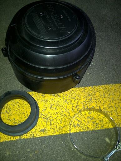

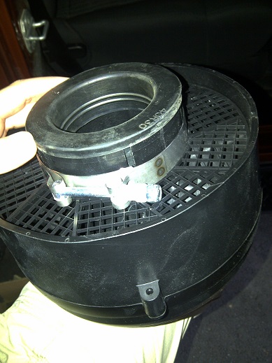

Can this be added to the AEV snorkel? Or does anything work with the AEV version. I couldn't believe how dirty my air filter was this past summer after one dusty run. What about turning the snorkel head facing backwards just for the day... Would that help??
Originally Posted by Maertz
i dont personally have an aev, but i would assume most snorkels tops are the same diameter wich if i recall was 3"?
It is 2.9" (just measured it), so should take 3" accessories just fine.
The old AEV snorkel has the 3" diameter tube, the newer one has 4".
I used a rubber insert to fit the new pre-cleaner to my 1st gen. snorkel.

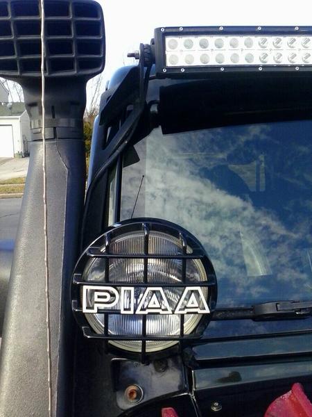

I got the river raider breather extension kit and it tied it all into my aev snorkel. Half hour to install the kit. I also have a psc mount for my 50" so ur eauto mount should work

why wouldn't you have just bought the top spin with a 3" opening? I bought mine new for under 40 bucks.

The AEV precleaner is at least partly a proprietary design by a company called Sy-Klone. They do these for industrial applications, so it may be more effective, although I don't know that for sure.
