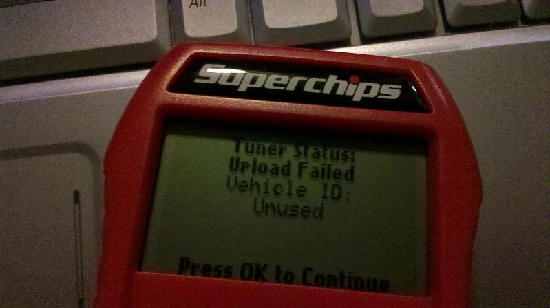

This is what I get when I "update". Is this good to go or is something missing?

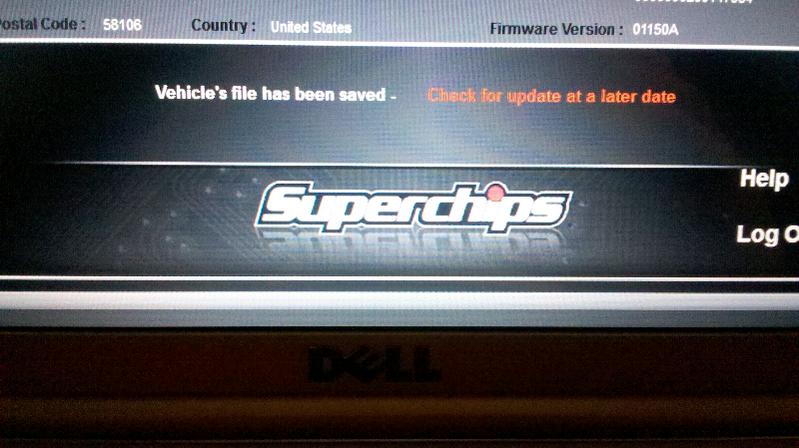

Also I get this on the tuner under "vehicle information".

After mine updates/syncs it pulls up the store and has the option to download the available options ie. The off road tpms option. Have you installed that? That would verify you are up to date.
During my update the pie timer goes to the right in a complete circle then goes backward. This takes several minutes. Then when complete the screen defaults to the store with available files to download.
Fyi... Mine showed that exact error under status until I got it to update properly.
Did you try to just change your tpms pressure without the tune to verify it is communicating with your Jeep? Try that and if it works then hook it up to your computer and download that off road tpms file frim the store (it's free) to force an update to the tuner and then try again to load the tune to your Jeep.
