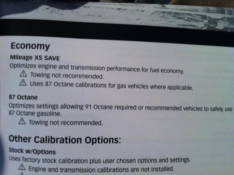

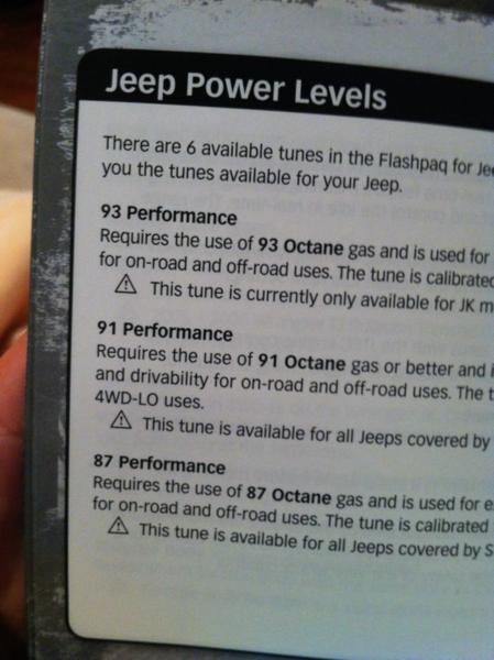

Ok, so I was able to update the software AND I even installed the TPMS OffRoad function. I went into the Jeep and the new TPMS option showed up. AWESOME.
However, I still don't see an 87 "Performance" tune under the Quick Tune or anywhere else for that matter. In the manual, under "Jeep Power Levels" on page 14, it shows:
93 Performance
91 Performance
87 Performance
Towing Tune
Crawling Tune
Except "87 Performance" is absent from the list on the Flashpaq when hooked into the Jeep. WTF? am I nuts? Or is the "87 Octane" option the same damn thing? Pics attached from the manual(also a PDF on Superchips website):

The 87 is the same thing. Jeeps were not required to run premium so there is no tune to tune it down. The 87 is a performance tune better than stock just not as good as the other prem gas tunes and why it is labeled as such.

That makes sense... but what doesn't make sense is that the manual lists an 87 Performance setting, yet it's not on the Flashpaq. Only 87 Octane.
Also, it's debatable whether the 87 Tune is better than stock if you're talking about performance vs fuel economy. Having run a bunch of different tunes, I now switched back to Stock for this fuel cycle and will be crunching the numbers. Thanks for all the help guys!!
